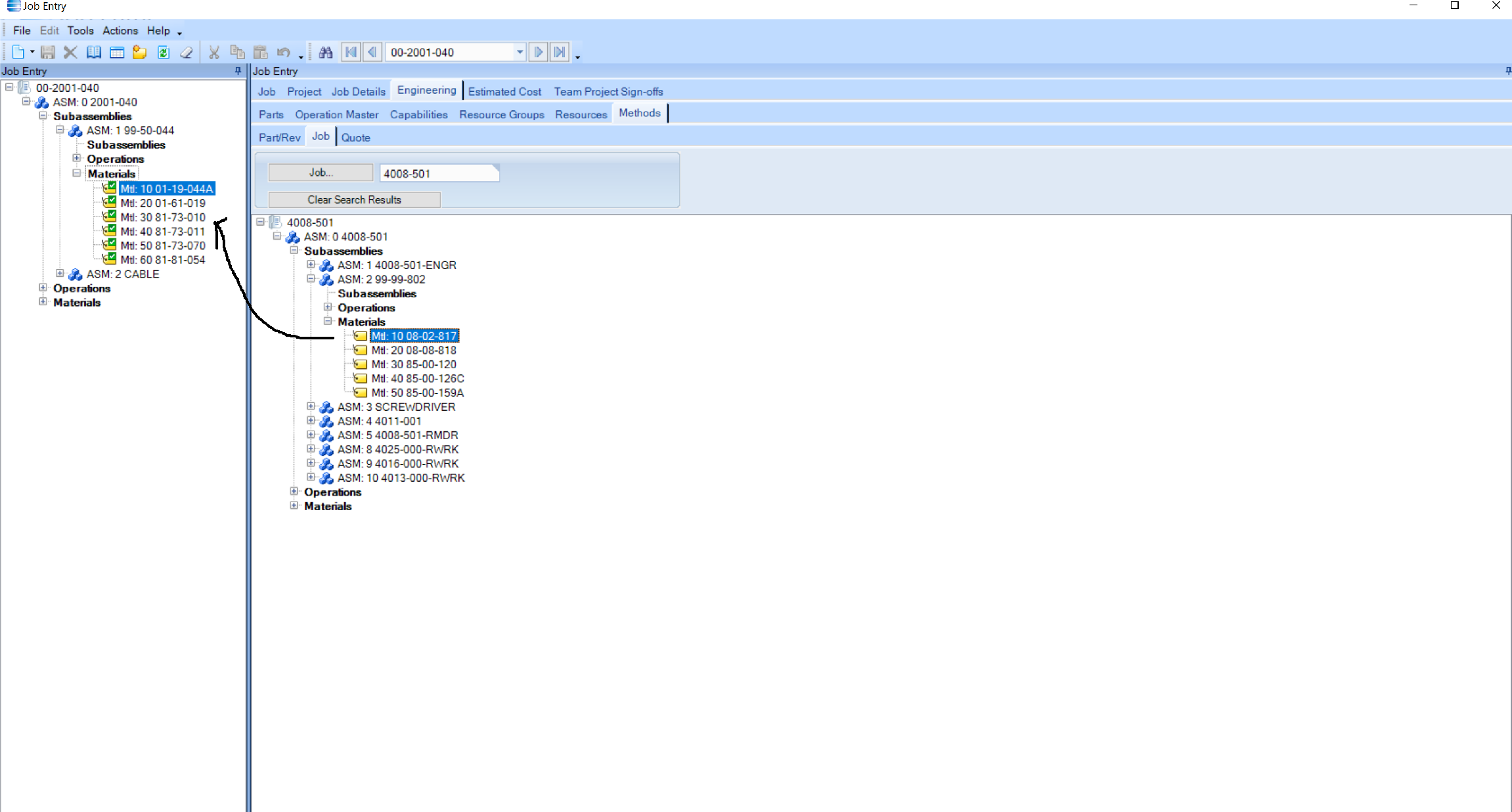

it is fairly simple, you go to the engineering section and you can recall any job, and then drag the components from that job into your current job. this allows you to selectively get individual materials or operations from previous job(s).
Tim explained it well, but here’s a screenshot for a visual look. It’s from E9.05, but is the same idea. After un-engineering and un-releasing a job in Job Entry, you can navigate through the tabs as he said. From the Jobs tabs, you can select a different job and see the operations and materials and drag-and-drop them from that main pane into the left tree view for the current job. We stumbled across this by accident one day but it’s definitely been a time-saver for anyone entering parts into jobs!
