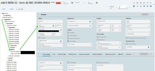

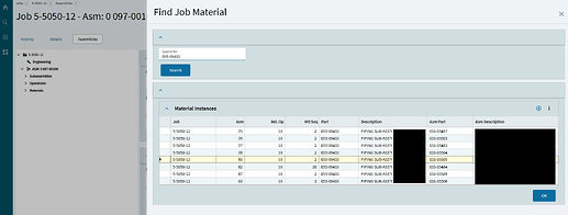

I figured I’d complete the cycle and create a Find Job Material Part “tool”.
Find Job Material by PartNum - tool
Choose the instance you want (as the same material could appear in multiple places on large jobs):
Tree Refreshes to desired Material record:
Nuts & Bolts details below should you like to recreate for yourselves…

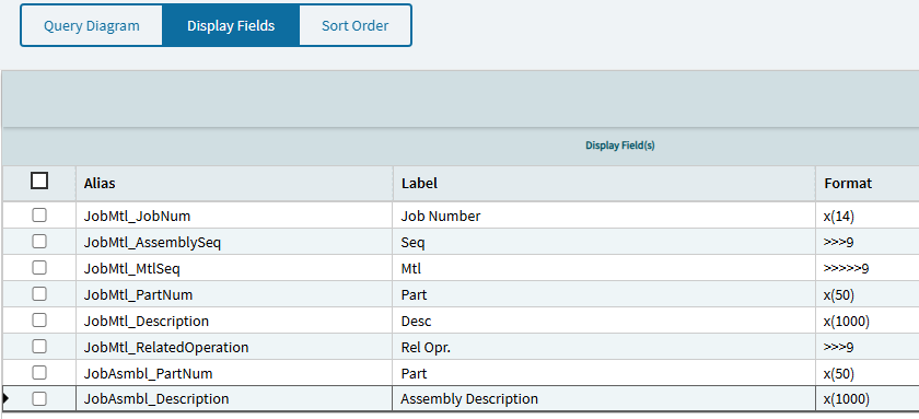

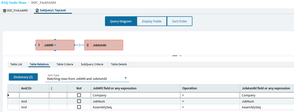

As before, we’ll start with pretty simple BAQ:
Querying the JobMtl table and linking JobAsmbl for a little detail:
(Feel free to expand on this BAQ as much as you want/need based on the details you want to display in the resulting grid).
Set to Shared, Save. Done.

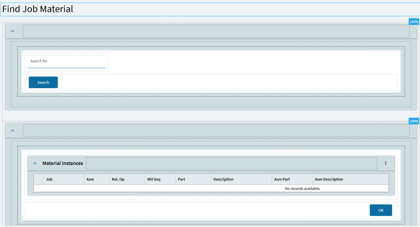

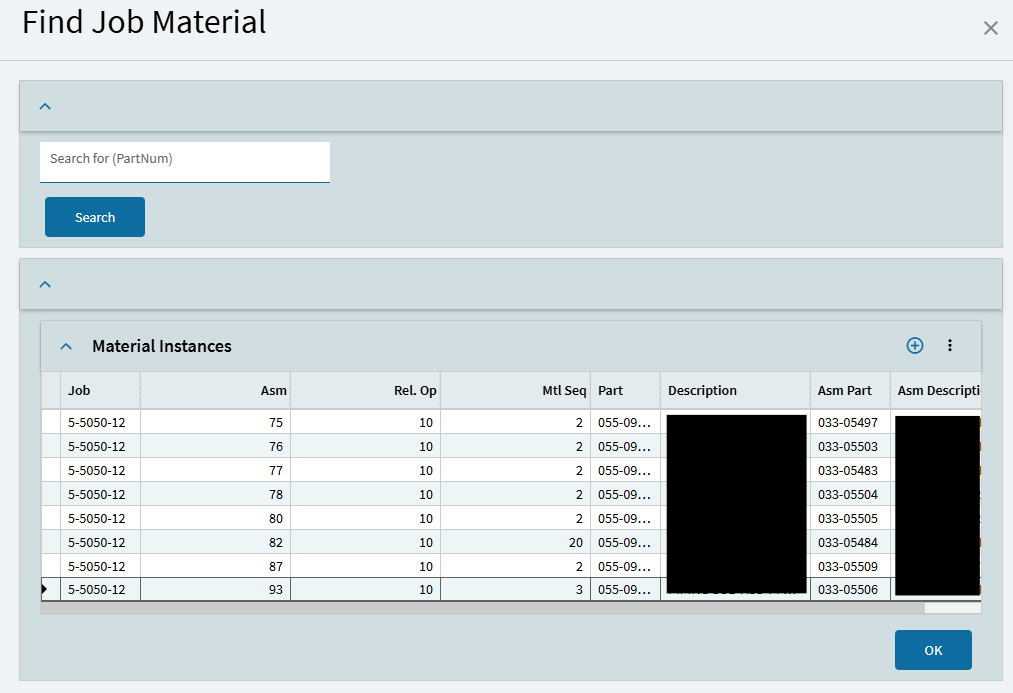

App Studio - New Page - Find Job Material
Add a new slider page.
Form:
Top Panel Card:
Textbox bound to TransView.FindJobMtl
Search Button
Second Panel Card:
I created a parent panel card so I could pull the “OK” button closer to the action. So I ended up with a panel card grid IN a panel card.
Panel Card Grid > Grid Model > bind the grid to your BAQ dataview and set up your columns.
Add an “OK” button
Save. Done with form.

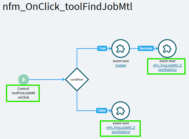

Event #2 - OnClick_toolFindJobMtl
search for the stock OnClick_toolFindAsm event, right-click and copy.
Rename
Change the trigger to onClick of your FindJobMtl tool
Change the event-next(2) to your new slider-open event (event #1 above)
Save.
Preview (if you wish), your tool should now open your slide-out panel.

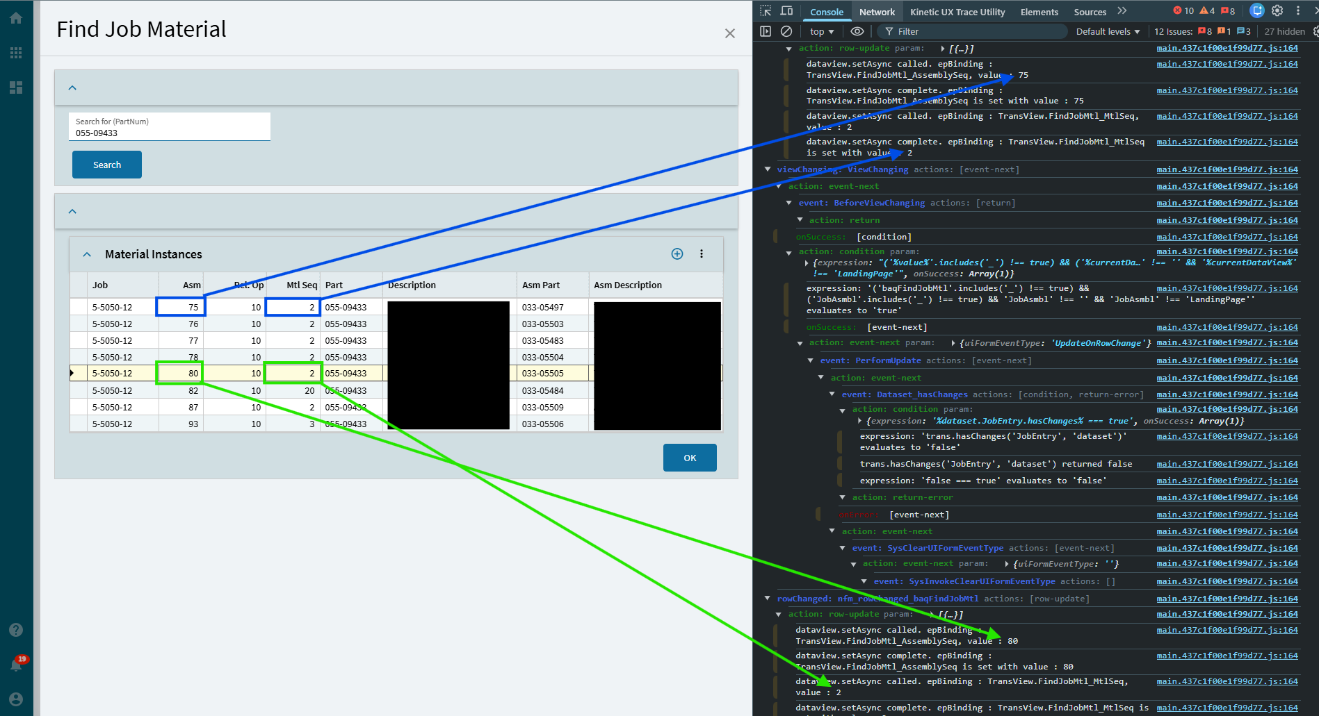

Event #3 - FindJobMtl_Search
Back on your FindJobMtl page, we need to add an onClick event to the Search button to call our BAQ.
event-next > set to call your BAQ “get” event
onSuccess > Row-Update
Note we are going to have (2) columns in our row-update:
First:
Binding: TransView.FindJobMtl_AssemblySeq
Value: "{baqFindJobMtl.JobMtl_AssemblySeq}"
Second:
Binding: TransView.FindJobMtl_MtlSeq
Value: "{baqFindJobMtl.JobMtl_MtlSeq}"
This is capturing the default (first row’s) values for AssemblySeq and MtlSeq when the BAQ runs.
Save

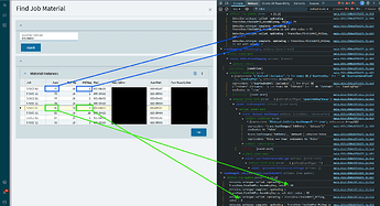

Event #4 - RowChanged_baqDataView
This is just a simple event to capture new values if the user selects a different row in our FindJobMtl grid.
Row-update… same settings as the previous event.
Save.
Preview. At this point, you should see your slider open, and if you enter a valid material PartNum, you should see your grid populate. If you select a different row in the grid, you should also see our TransView columns update their respective values.

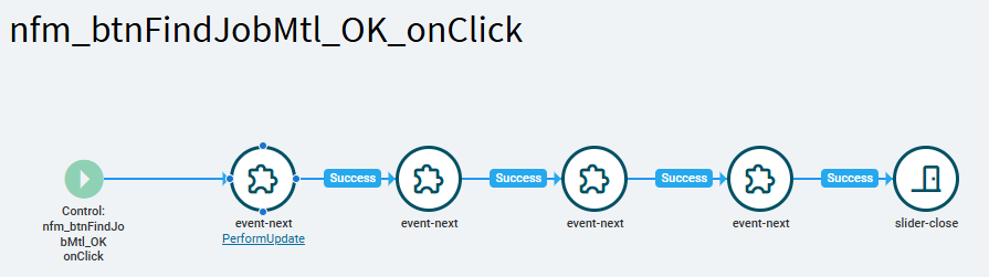

Event #5 - Our Form’s “OK” onClick event (the Big One!)
This is going to be a chain of event-nexts. So, we’ll set up the structure and then come back to this one to fill in the gaps.
Trigger: OnClick of your form’s “OK” button
(4) event-next(s)
Slider-Close
You can go ahead and assign the first event-next to the PerformUpdate stock event.
Save… we’ll come back to this one.

Event #5 - Revisited
Now, go back to Event #5 (your “OK” onClick event) and plug in events 6, 7, & 8 in the (3) empty event-next(s).
Save.

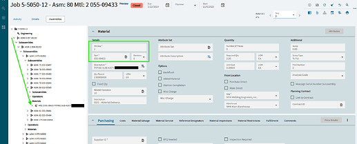

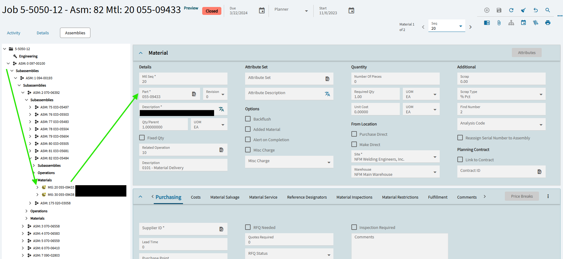

Preview & Test
You Tree should successfully refresh to the desired Job Material:
That is awesome!
