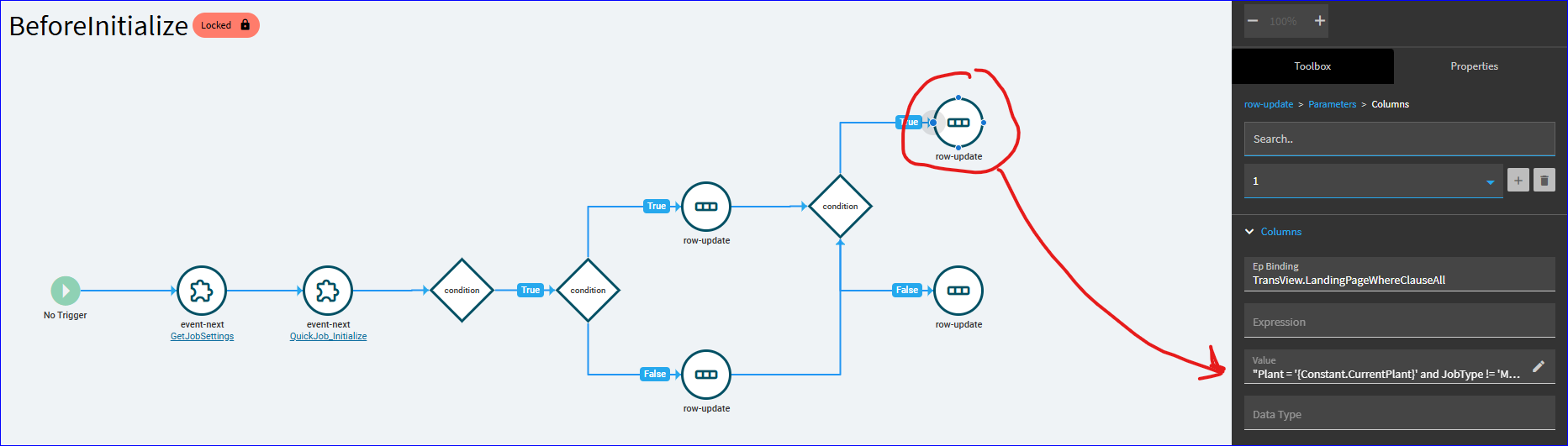

They’re defined via a row-update to TransView columns in the BeforeInitialize Event:

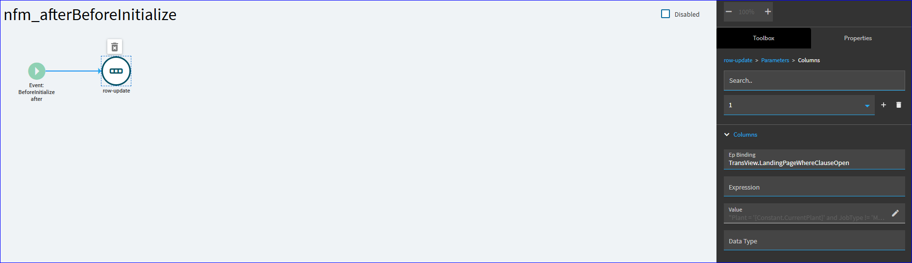

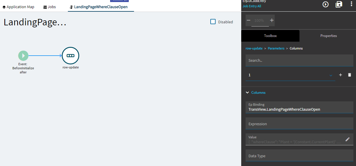

So, I would start by making a new event that runs after BeforeInitialize:
We’ll use a Row Update to set up a new “Open” TransView column. That way you’re not working against base functionality, you’re just building a new option.
RowUpdate Binding: TransView.LandingPageWhereClauseOpen
RowUpdate Value (JSON):
"Plant = '{Constant.CurrentPlant}' and JobType != 'MNT' and JobClosed = false BY CreateDate desc, JobNum desc"

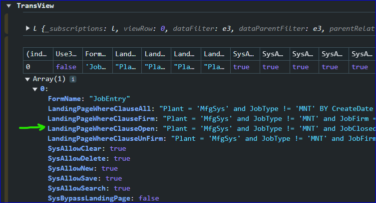

If the event works and you preview now… you’ll see our new TransView column ready to be used in the debugger:

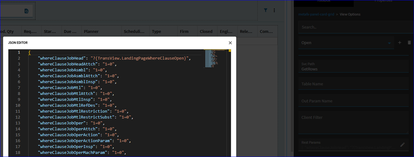

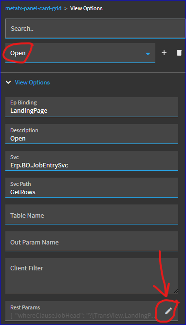

Open the View Options on the landing page grid Properties > Advanced > View Options. The first one is “All”… take note of all those settings… also copy the Rest Params from the “All” view (JSON) and paste them into Notepad or whatever you prefer, we’ll need those in a second and you don’t want to have to retype them all.
Create a NEW view and use all the same settings as the original “All” view… except set the description to “Open”. Paste a copy of all the Rest Parameters into the new “Open” view. You only need to change the top parameter from the original:

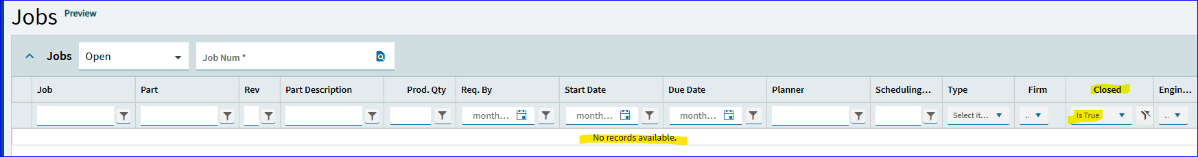

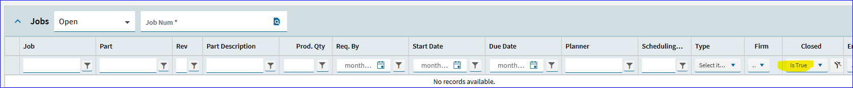

If it worked, you should get results in your landing page grid and to test… Add a filter on the “Closed” column… set it to IS TRUE.
Since your view should only include Open jobs, but you just asked for only CLOSED jobs… you should get “No records available.” This tells you your View parameters worked:

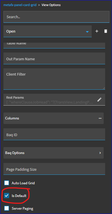

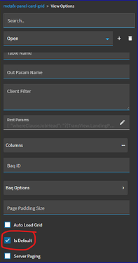

Back in App Studio, check the “Is Default” option on the new Open View for your Landing Page Grid.
Preview again. If it doesn’t load the page with your new “Open” view as default. Look at all the other available Views and make sure they’re not ALSO checked with the default setting. Setting one doesn’t appear to clear the others.

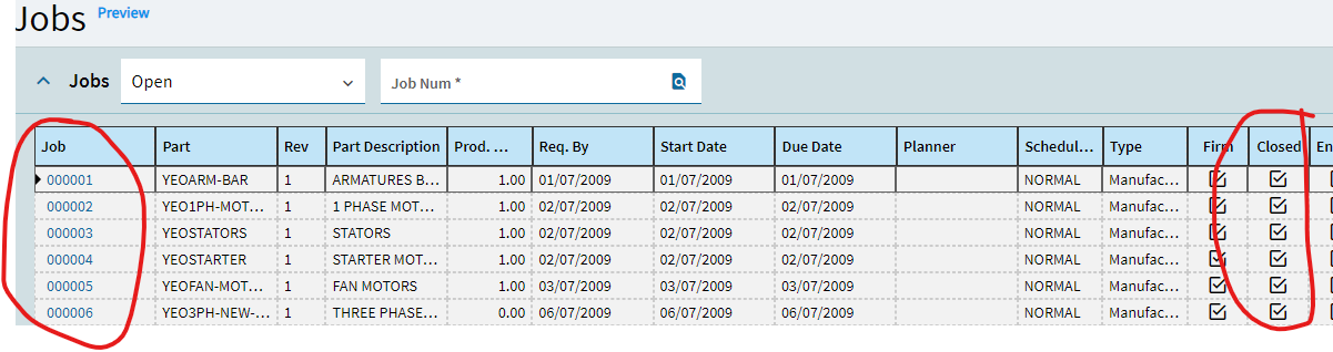

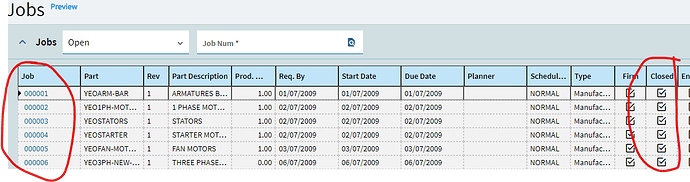

I now have the view ‘Open’ and when launching Job Entry it opens as ‘Open’ but there are closed jobs still in the view.
The only thing I can see that I didn differently is I omitted the JobType - any ideas??

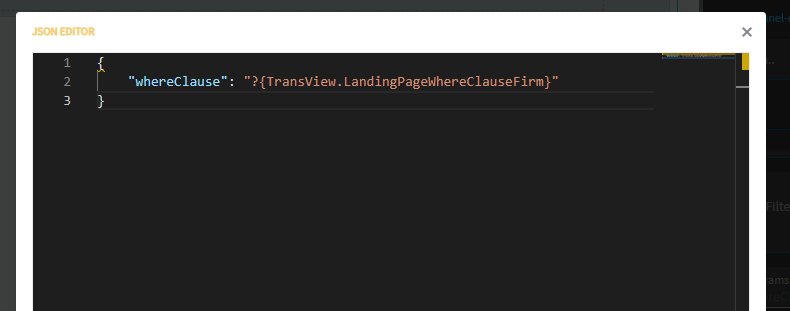

Can you double check/verify that top line in your View parameters is correct on your end?
Sorry not sure how to do that bit?

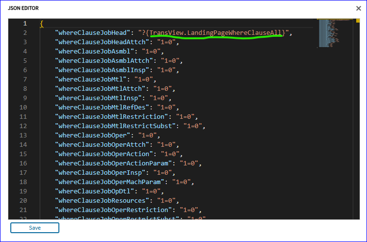

So, edit your landing page… when that opens, click on your grid and click on Properties. Scroll down to Advanced and click on View Options.

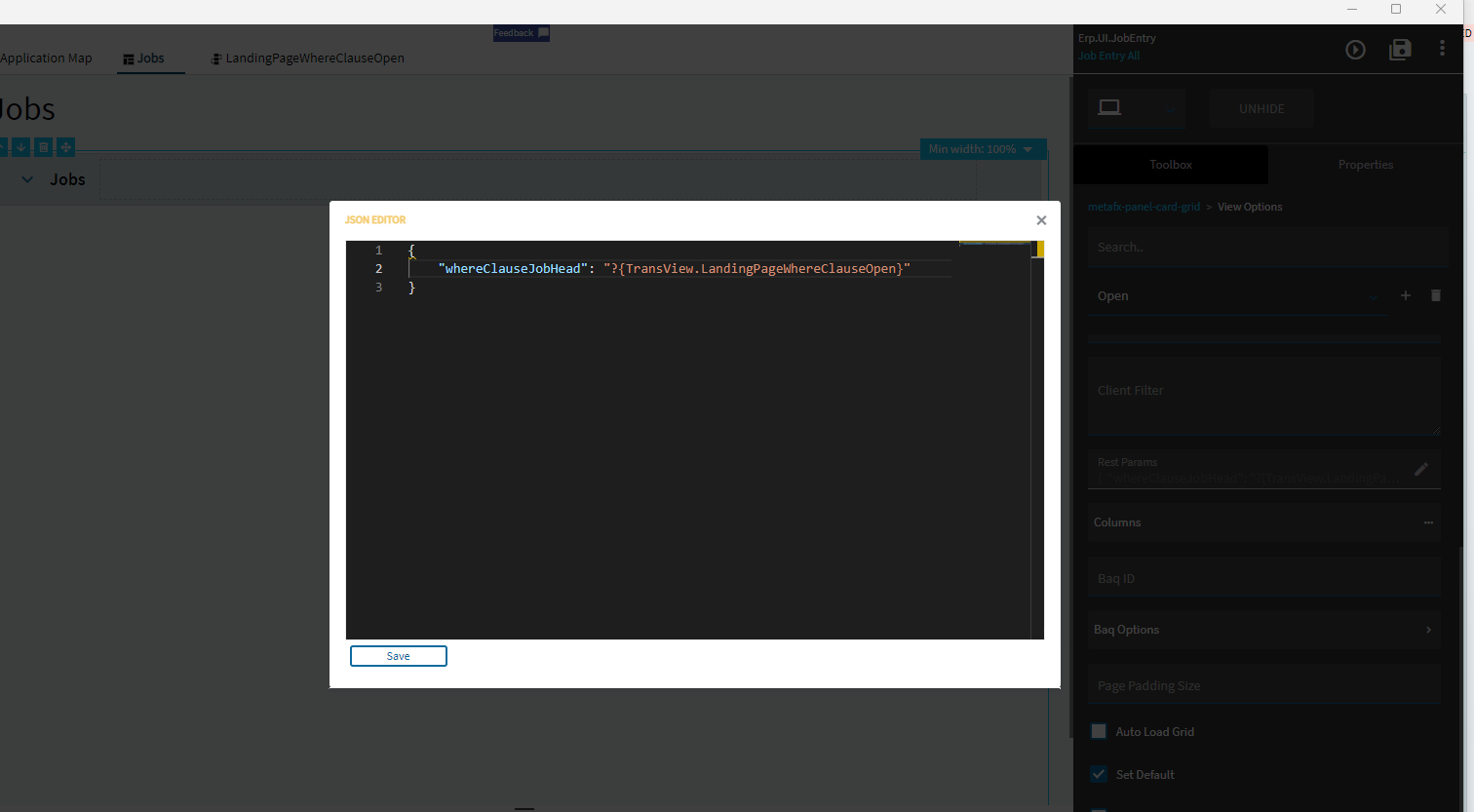

Select your “Open” view and then click on the pencil and show me what’s in the JSON window that pops up:
Really appreciate your patience here

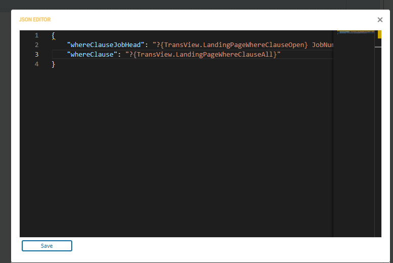

As you can see, it shows closed orders and the jobnum is not desc

So, I think you still need all the other parameters (there are a bunch!).
So, open the “All” view and copy all of them! Then go to your “Open” view and paste them all in!
Then, just change the top one to your Open transview clause. See if that works better.
So now its displaying the jobs in the order I want as in newest at the top but its still including closed orders
No… it should look like this:
See how many parameters there are?
Are those NOT in your “All” view?
No all I have is that 1 line in my All view

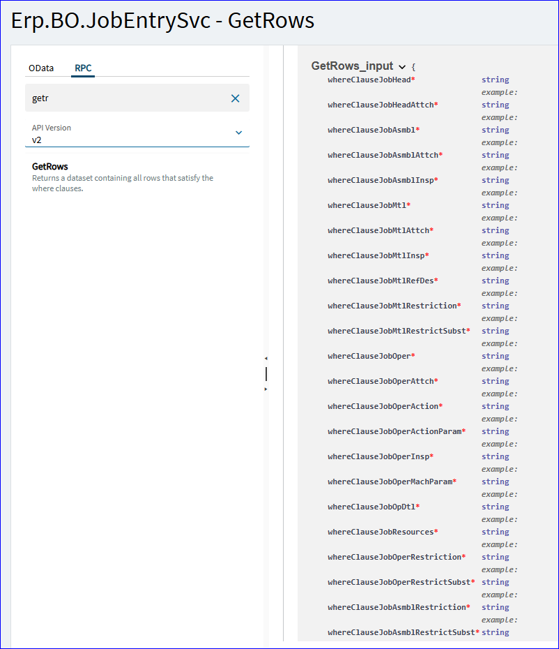

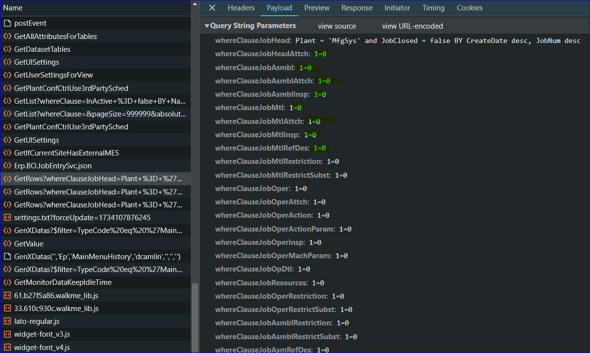

The reason you need them ALL is because you’re populating this landing page view via a rest-call:
The GetRows service is expecting ALL OF THESE INPUTS:
It will then want to send back a response based on those inputs.
We only CARE about the JobHead, so we give that a parameter that means something… and everything else gets a parameter of “1=0”…which is a false statement… so it won’t return anything for those, but we still have to include them or the call itself will fail.

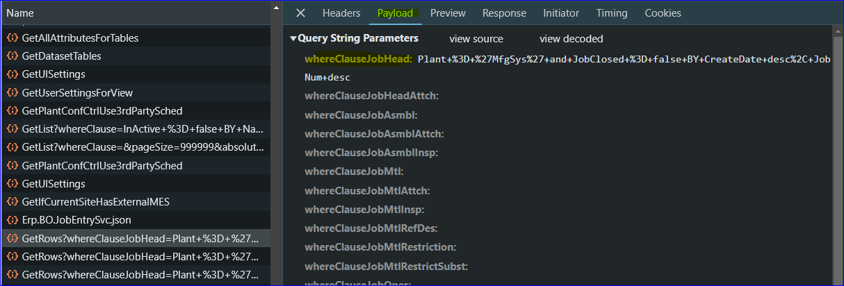

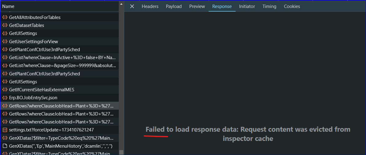

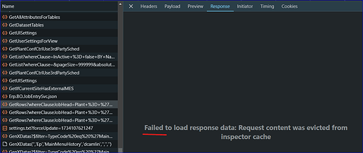

If you evaluate this in the Debugger… (I set mine up the way you had yours)…
The Payload is what you’re sending… and we’re only sending 1 out of many parameters:
In that case, the Response is a failure:
If you include all the parameters… it’ll look like this:
Payload (includes everything):
So Response will be all records that meet those parameters.
Check your other views… Firm / Unfirm. Do THEY have more parameters?

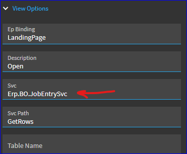

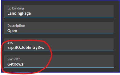

You’re in an older version… perhaps Epicor changed what service they’re using here.
Are these the same services your stock views are using (All, Firm, Unfirm)?
So my Firm and Unfirm are similar to the ALL

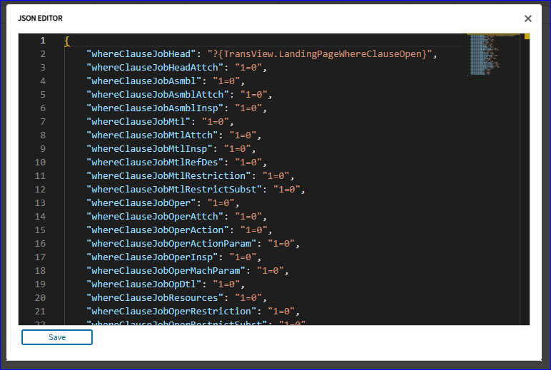

Copy the below and paste them into your “Open” view… let’s see what happens…
"whereClauseJobHead": "?{TransView.LandingPageWhereClauseOpen}",
"whereClauseJobHeadAttch": "1=0",
"whereClauseJobAsmbl": "1=0",
"whereClauseJobAsmblAttch": "1=0",
"whereClauseJobAsmblInsp": "1=0",
"whereClauseJobMtl": "1=0",
"whereClauseJobMtlAttch": "1=0",
"whereClauseJobMtlInsp": "1=0",
"whereClauseJobMtlRefDes": "1=0",
"whereClauseJobMtlRestriction": "1=0",
"whereClauseJobMtlRestrictSubst": "1=0",
"whereClauseJobOper": "1=0",
"whereClauseJobOperAttch": "1=0",
"whereClauseJobOperAction": "1=0",
"whereClauseJobOperActionParam": "1=0",
"whereClauseJobOperInsp": "1=0",
"whereClauseJobOperMachParam": "1=0",
"whereClauseJobOpDtl": "1=0",
"whereClauseJobResources": "1=0",
"whereClauseJobOperRestriction": "1=0",
"whereClauseJobOperRestrictSubst": "1=0",
"whereClauseJobAsmblRestriction": "1=0",
"whereClauseJobAsmblRestrictSubst": "1=0",
"whereClauseJobAsmRefDes": "1=0",
"whereClauseJobAudit": "1=0",
"whereClauseJobPart": "1=0",
"whereClauseJobProd": "1=0",
"whereClauseJobStage": "1=0"
