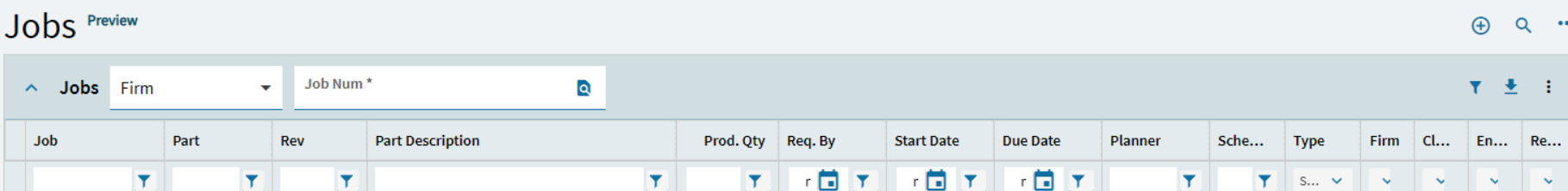

Job Entry page, how do I add the ResourceGrID column? Is there a way?

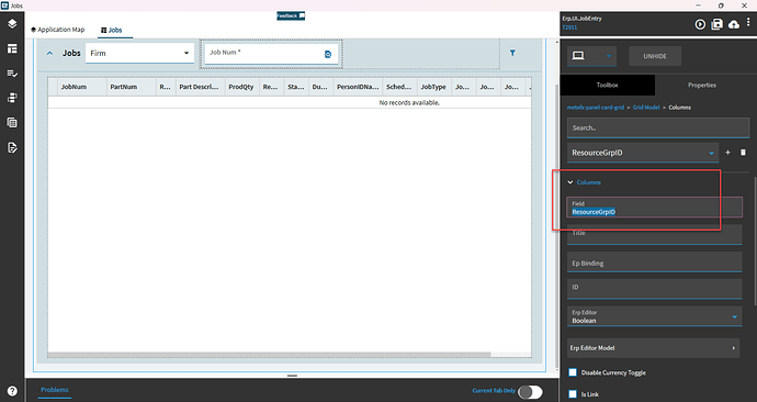

Job Entry page, how do I add the Resource GrID column? Is there a way?
I am sure there is a way to do this, but the Resource Group does not live on the JobHead table. So, unless all of your jobs only have one operation with one scheduled resource, it will end up duplicating lines in the grid.
