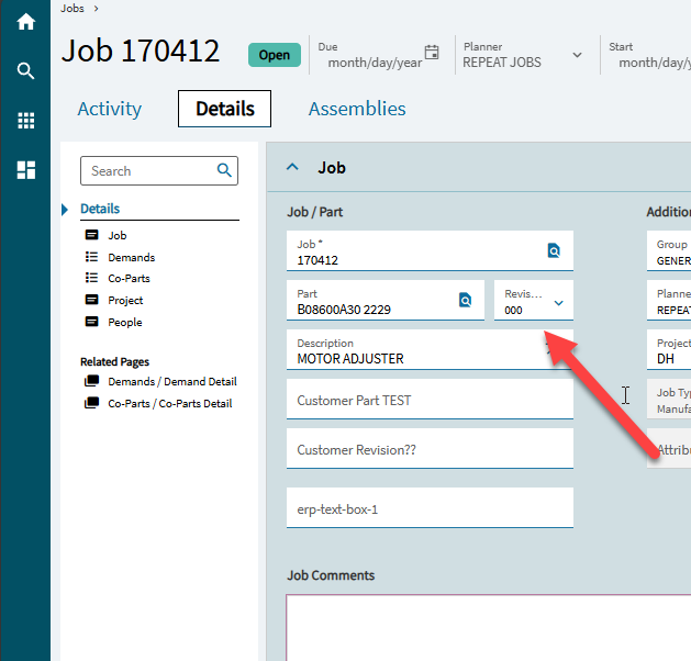

In Epicor 9 we could change the job part number revision when the customer made a change and revised the print. It is not allowing us to change it or delete it. We were able to change it in Order entry. I tried removing the demand link and changing it but still no dice. I even went into customer part entry and deleted the part and still doesn’t allow me to change it.
We noticed this on subassemblies in the job as well. It will not allow us to change the revision.
Any ideas?

Job is not scheduled or released.
You can type and edit the field it just doesn’t stick.
This part isn’t setup in the part master so there should not be anything forcing a revision.
