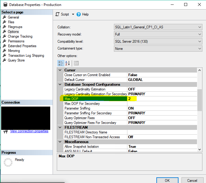

I have a workaround to this. In SSMS, change the Max DOP for the database from anything to anything else. It instantly frees up the hanging screen and all users can operate normally again. Sometimes I don’t see the problem again for weeks. Other times it happens two days in a row (like yesterday and today).

The fact that changing something in sql fixes it leads me to believe you are having some sort of locks on the db or your CPU on sql is pegged?
Yeah, I have to assume that changing MaxDOP either kills all active processes against the db or wipes query execution cache, something like that… This does sound like some kind of lock.

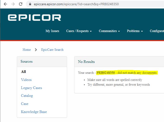

Interesting. Unfortunately I could not pull up the PRB on EpicCare and even searching for CheckValidRevision did not return anything on EpicCare. I don’t understand why these PRBs are private sometimes.

Seriously, am I doing something wrong? I thought PRBs were public info, no?
You aren’t missing any information - they haven’t worked on it since telling me I could close the case, because the created a problem for it. That was March 23, 2022
They have bigger fish to fry I guess.

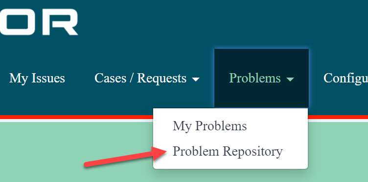

I’ve only been able to see PRB’s that are linked to my cases, not others. Also, PRB’s won’t show up in ‘My Problems’ for us customers until development accepts them. The first stage where EpiCare support submits the PRB, but Dev hasn’t accepted it yet (e.g. maybe it’ll get rejected with the famous ‘Working As Designed!’) will not be visible to us.
EpiCare Search seems to miss a lot of things… I think you have to go to the Problem Repository, and then you can see them all:

I ran into this today (absurdly slow loading of Job Entry, like 60x as long) and the Max DOP fixed it immediately. Always does.
Actually this happens a few times a year. Not constantly; just every other month or so. We’re on Kinetic 2023.2 now.
