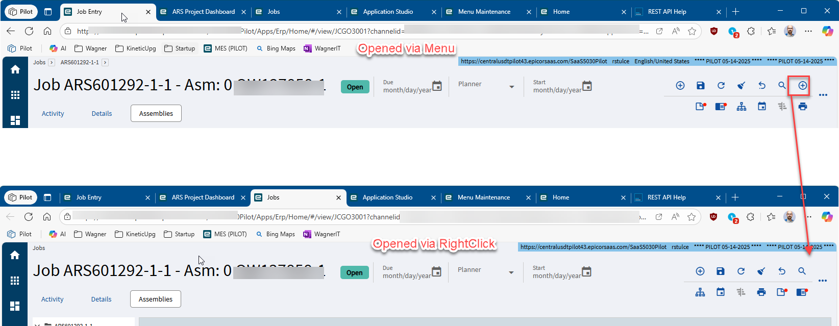

We’re gearing up for KineticUI testing and we noticed something weird with Job Entry if it’s opened via right-click or via the menu. I thought it was because the context menu wasn’t set to open the correct layer but that’s not the case I verified in the URL from both tabs, menu JCGO3001. I even tried this via base KineticUI forms and got the same issues:

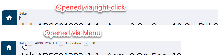

The bread crumbs don’t show if right-click opened:
Browser tab titles are also different:
And the Add SubCon button doesn’t show:
None of this seems a no-go issue as navigating the form doesn’t require the bread crumbs and adding a subcon operation can still be done via right-clicking on Operations in the left tree. But it’s something our users noticed.

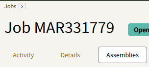

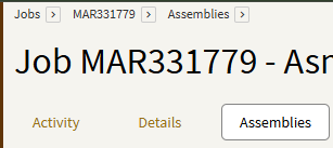

The breadcrumb trail is erratic, even without right-click. Just click back and forth between Details and Assemblies
Job Entry > click on job. Breadcrumb: “Jobs>”
Then click on Assemblies. Breadcrumb: “Jobs> jobnum > Assemblies”
Click back to Details. Breadcrumb: “Jobs>”
Click back to Assemblies. Breadcrumb: “Jobs>” Why u no breadcrumb???
