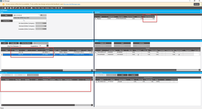

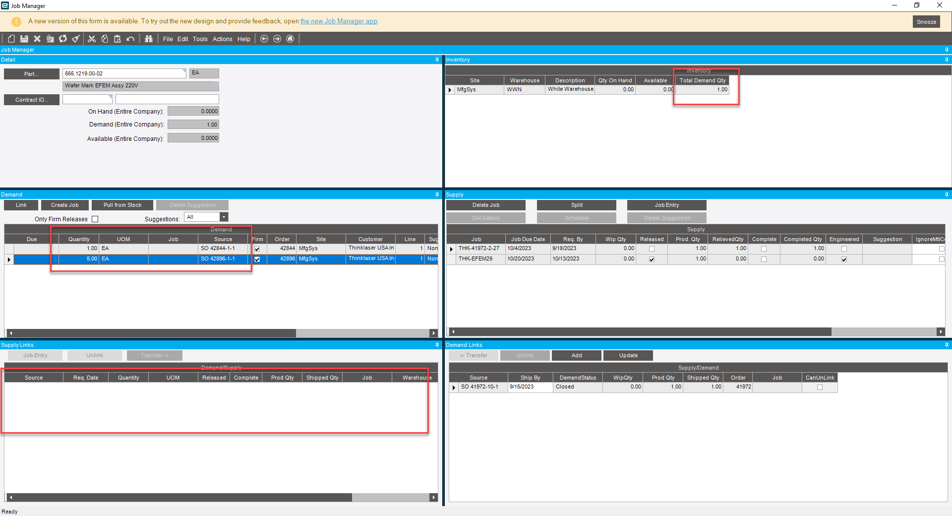

Hi,
I’m having an issue where I created a SO for a part, after I run MRP I check the Job Manager for that part and I can see demand for 6 from 2 SO’s under the Demand section but under Inventory Section the deman only shows 1, also for the 2nd So under the demand section its not showing any Jobs for it, what am I missing?

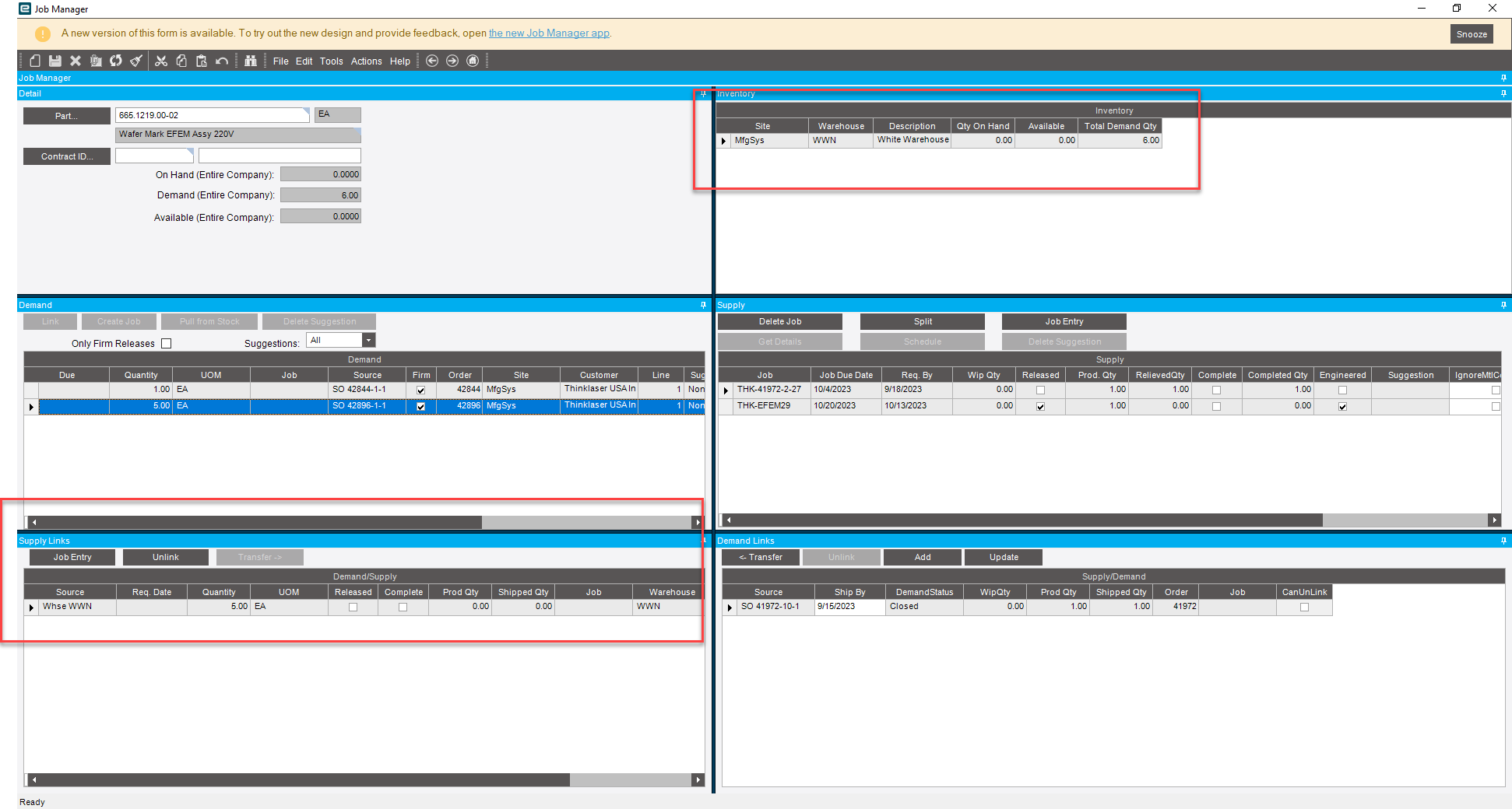

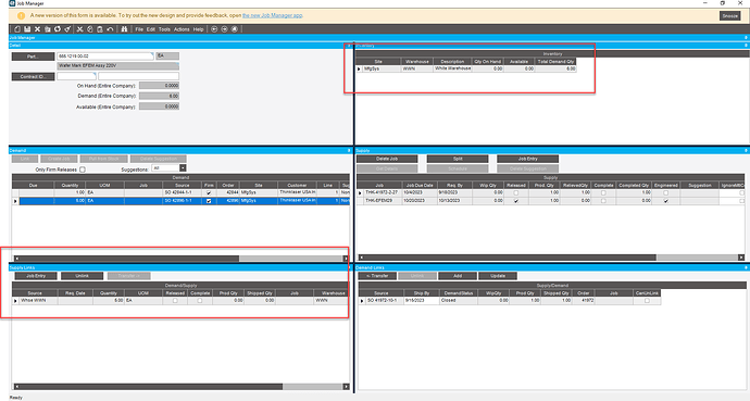

I got the demand to show but its showing the supply will be from stock, but I dont have enough in stock to fullfill it…

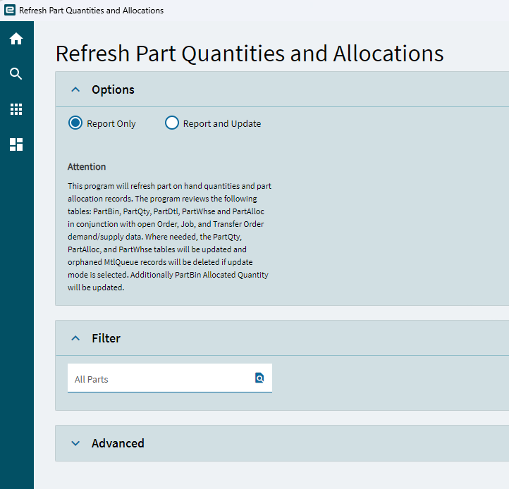

You may want to run this in Report Only mode for that part and see what it says.
