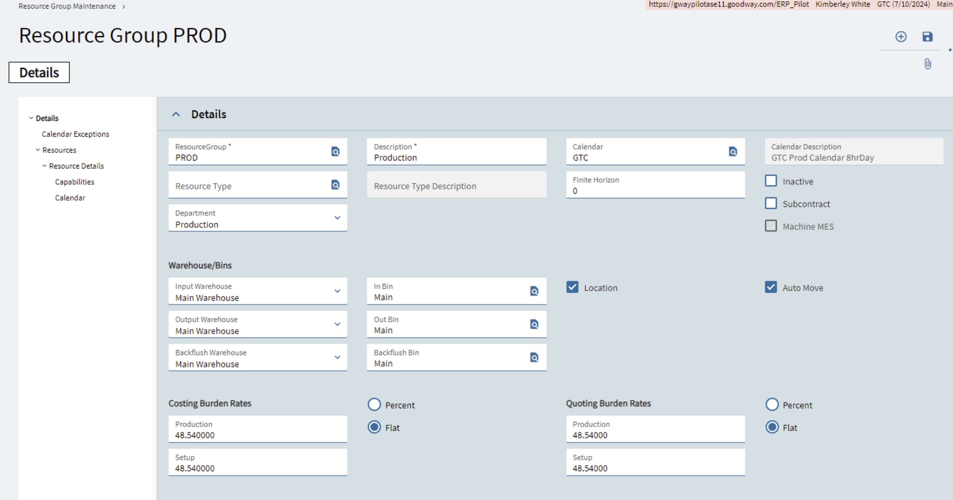

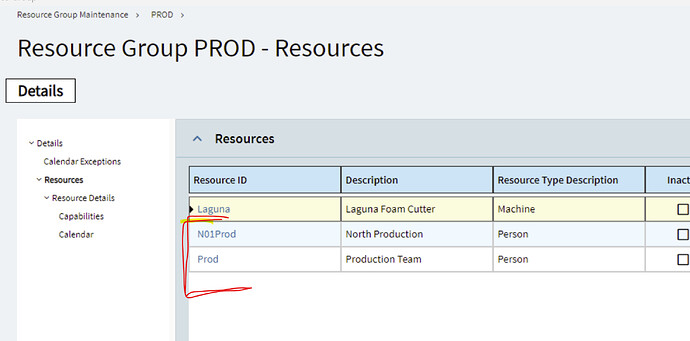

Here is my Resource Group and Resources on the group we use. We only have Prod as we are a small company.

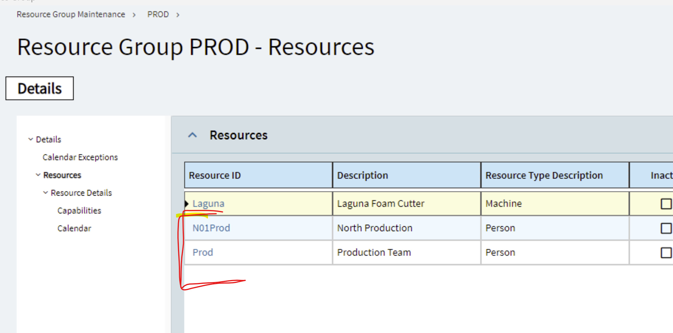

The N01Prod and Prod are the 2 resources we want to use.

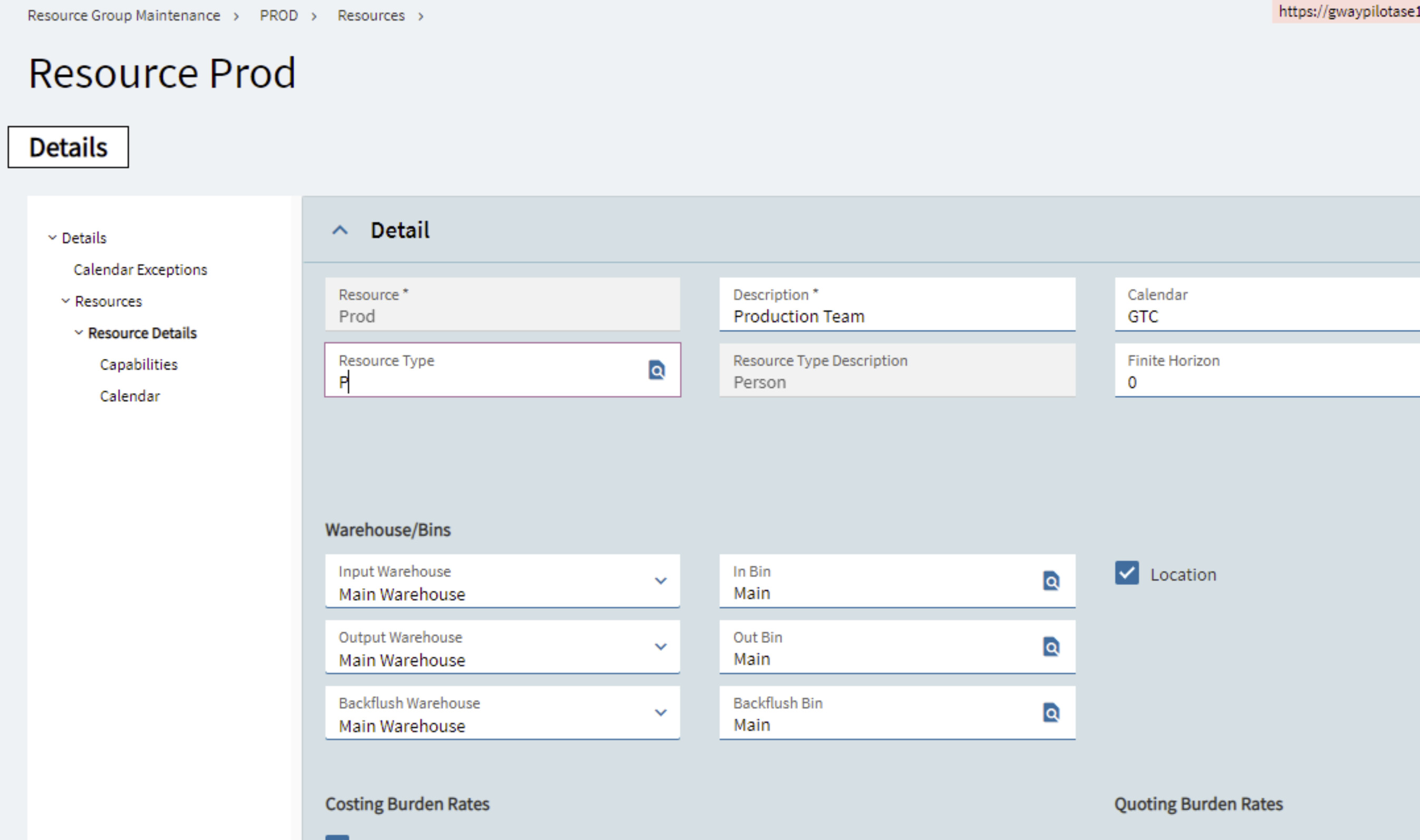

Resource Prod

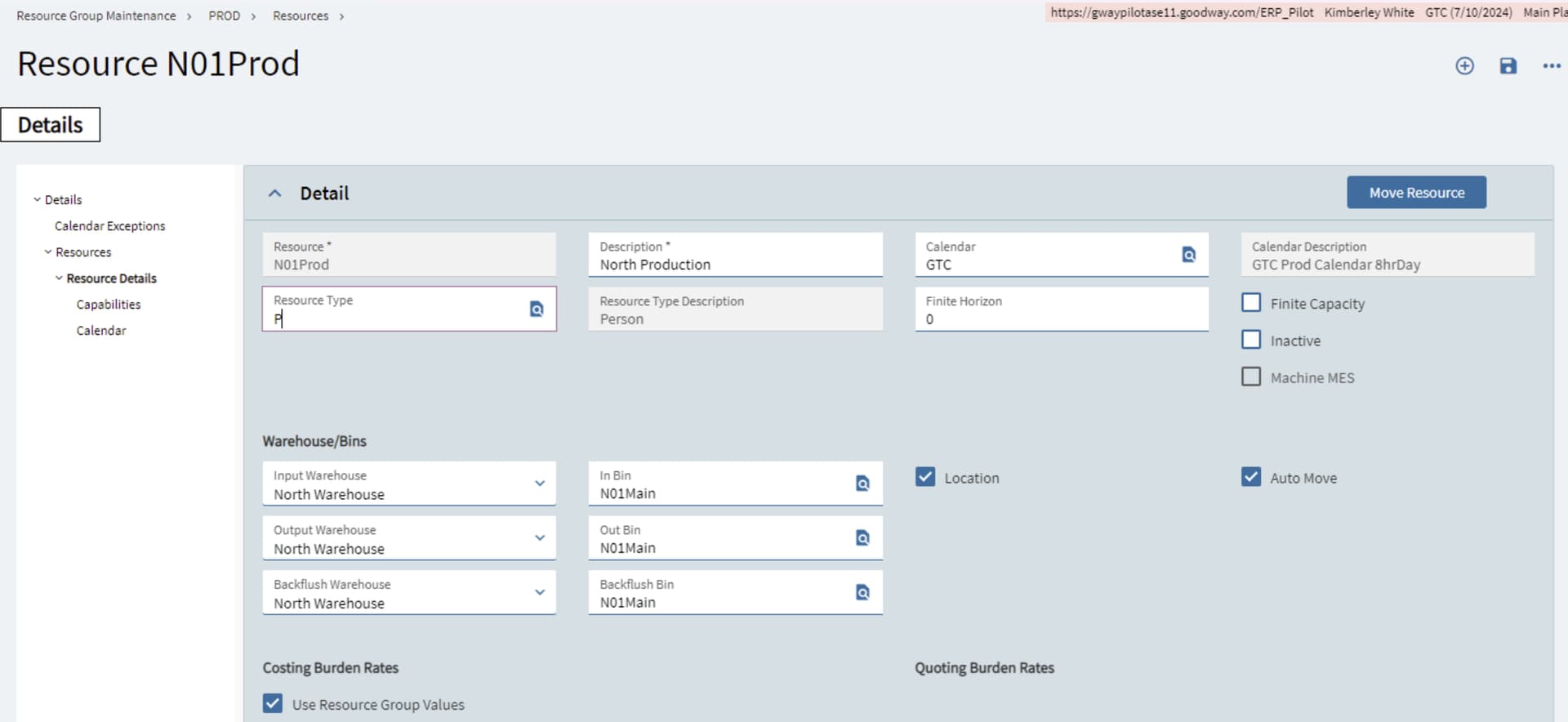

Resource N01Prod
