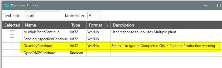

There is a field in the DMT template to override that popup
Whoops… There is not a bypass for that.
I was thinking job closing when produced qty is less than the job qty.
