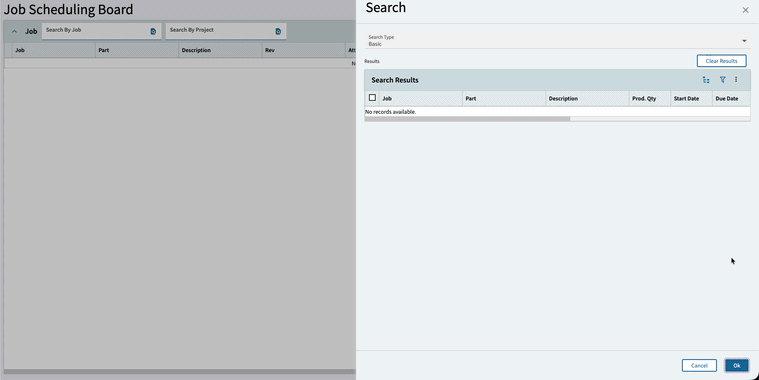

Anyone else having issues with job scheduling board? We did update to 100.7 and that broke a bunch of things so then updated to 100.8 to fix those and now we do not have a working job scheduling board. Just pops up like shown below. Can’t adjust schedule or see how it scheduled or anything.

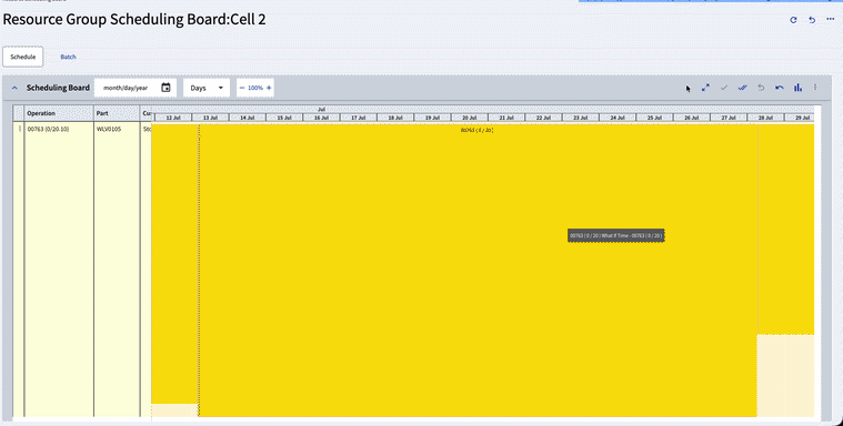

We updated to 12.2.100.9 last night and are experiencing the same issue. Our production is effectively down because both the Job Scheduling Board and Resource Scheduling Board are unusable.
In our case, all jobs appear briefly when the board loads, then immediately disappear, leaving only one job visible. This occurs for multiple users, so it doesn’t appear to be user specific.

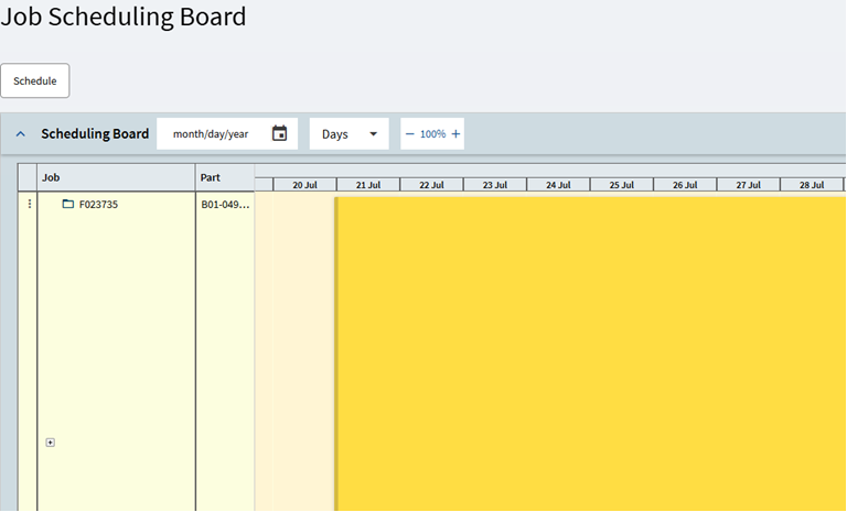

I should have scoured EpiUsers before doing the on Cadence update from 2026.100.7 to 2026.100.9. We now have this issue too. I’ve tried Chrome, Edge and Firefox and all 3 have this issue, which is in Job Scheduling Board and Resource Scheduling Board. I was hoping there would be some work arounds here.

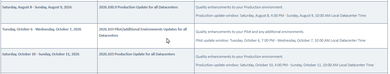

So . . . does anybody know when cloud will actually get that patch? Because when I look at the release schedule there are no more updates to cloud until 2026.103 in mid October. According to this it looks like .9 is the last update we will get for .100 but maybe I just don’t understand the chart? I don’t know.
Epic care told us the same thing last week.

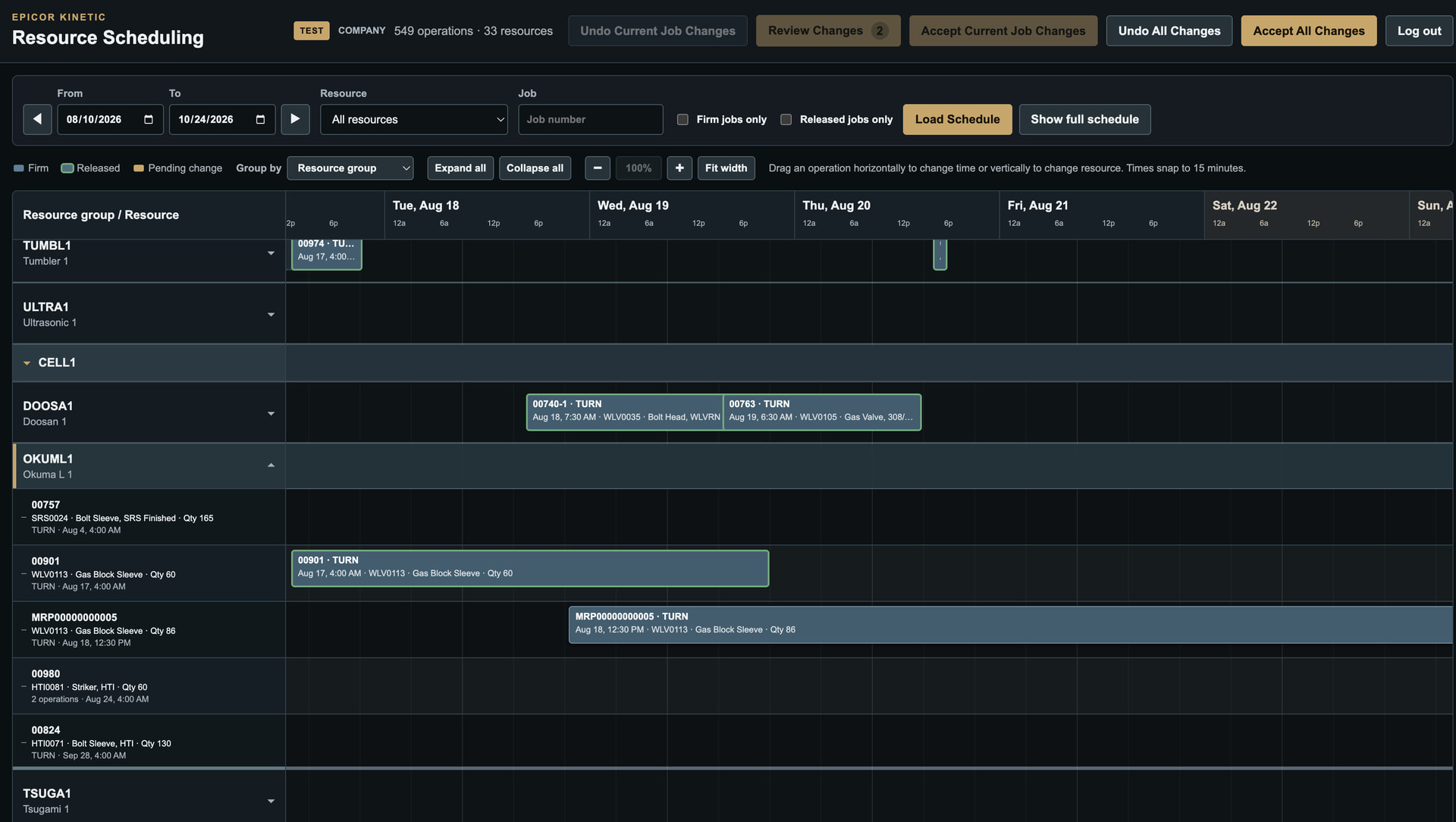

In desperation we built an external scheduling board that integrates with Epicor’s Resource Scheduling Board. I had to reverse engineer the service calls from Resource Scheduling Board. It was faster to use AI to help build what we needed than wait for a fix to a critical issue.
It’s finished now, and we’re testing it internally.
So far it runs smoother than the original lol.

That looks very nice, and clean… You can probably build in better tooltips and other things.
This looks awesome.
Are you sharing???
