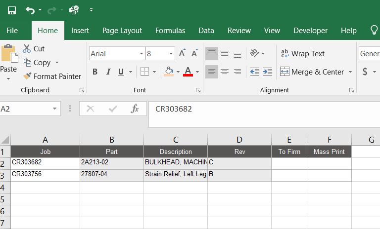

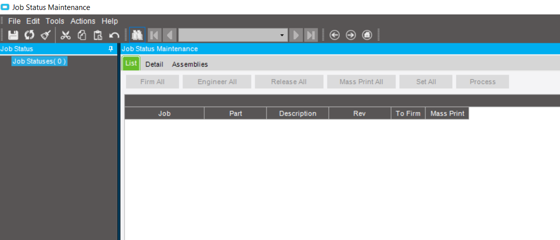

Hi Brad,
I’m running into the same issue when trying to paste insert to the into the List grid on JSM. Do you mind sharing the excel file format that you use do perform the paste insert function? I tried rearrange the columns on both JSM and Excel multiple times but still have this error: Unable to Complete Paste Operation.
Here is my setting:
Thanks,
