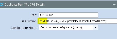

Seems that when you use Duplicate Part , whatever description you enter in the Duplicate Part dialog window:
Is what the Co-Part is set to.
Another test yields that the Co-Part Desc is set when a new revision is created. The Co-Part Desc is copied from the current part Desc.
So if you adjust the description prior to creating the new Rev, the Co-Part Desc will be set to the new one.

Thanks. Because we have multi-line descriptions, that duplicate window doesn’t work for us. We need to duplicate first with the description, then edit the description.
