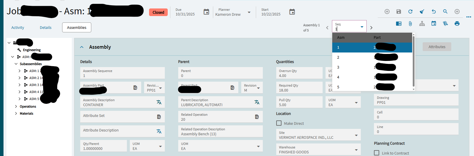

In Job Entry > assemblies > Look at the drop down list on the right side:
Thanks Nate,
The trouble with that control is that it only shows you the assemblies that are already visible in the tree.
What I want to do is input an assembly sequence that is buried x levels deep, and I’m not sure exactly where. That’s what the classic customization was able to provide.
I see… I don’t have a solution in that case. However, in your research take a look at Job Entry > Activity > Assembly Activity > Look at the asm seq drop down there. It does show every nested sub asm. Maybe you can tap into the code used to make that combo box? Good luck!
