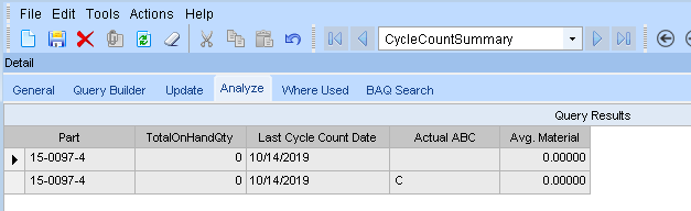

I’m noticing odd data in sanity checking my BAQ. I’m seeing multiple rows for the same PN with different ABC codes, and I’m seeing a lastCCDate for parts that don’t have any CC transactions in part tracker. Can someone point me in the right direction?
Super simple BAQ with just PartWhse and PartCost tables joined on Company and PartNumber.
PartCost is…complicated, but it can be specific to a plant/site, for example.
And I can’t remember about FIFO layers, if that’s stored in PartCost or not. FYI even if you don’t do FIFO costing, you can opt in to tracking the layers anyway…
