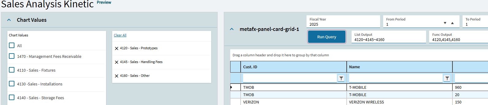

Using the erp-selection-list control to build a list of filter values. It allows to set a delimiter but that seems to be ignored, it’s alway building a ~ delimited string. My thought is to use a row-update to swap out the ~ with a comma and then pass that into the Having bit of the where clause when I execute the BAQ using the erp-baq action. I was trying something like this
(‘??{TransView.tvChartList}’).replace(‘~’,‘,’)
As I suspected, doesent work and not finding much syntax help.

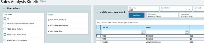

I wound up using a function to do this. When dashboards are converted Kinetic apps using the classic dashboard tool, it wires the execution of the underlying BAQ to an invalidate action. This is really noisy, running the BAQ many times when its not needed.
1 - I broke the binding to the BAQ on the grid and wired a button the run a BAQ action.
2 - I created a function that takes in a delimited string, a source delimiter and target delimiter.
3 - In the button click event, I pull the value from the selection list field that I have bound to TransView and pass it into my function.
4 - The value coming out of the function is captured in another system data view that is similar to TransView called actionResult.
5 - I then call my BAQ passing in the comma delimited list and get the correct results.

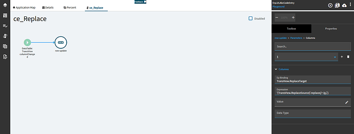

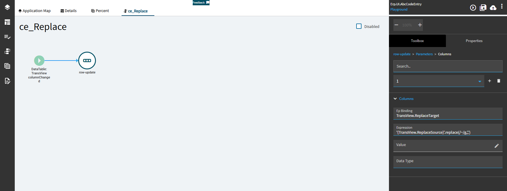

I know you already found a solution but for posterity, here’s the syntax.
I don’t believe you can use the ?? notation in a row-update, so you may want to check for null with a condition before the row-update.
'{TransView.ReplaceSource}'.replace(/~/g,',')
Worked perfect Hanna. This is an excellent alternative.
‘{TransView.tvFromString}’.replace(/{TransView.tvFromChar}/g,‘{TransView.tvToChar}’)
