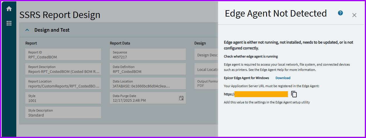

Well it was, but my pic IS the designer, right? (I launched from the browser, so it should pick Kinetic anyway.)
What I clicked on to get the Edge thing was the download. Like so:
:down_arrow:
That’s supposed to need Edge, right?
Oh right, yes it does require the edge agent to work, but it doesn’t require the classic client. The edge agent just has to point to the right app server.

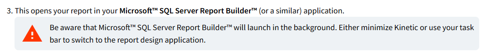

For me, I thought Report Builder was not launching. Turns out the server popup was hiding behind other windows. Had 4 of them till I noticed. :astonished_face:

Well yeah, but it never used to hide so well. It’s not on the task bar when it first comes up and it pops under the browser window. It’s livable, just wanted to warn others. It takes after the EAC regenerate data model design. Well that was at least on the task bar.
