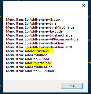

You have to determine what the tool key name is for those buttons easiest way is to use the ToolClick event with a message box to prompt the key.
From there you set that tool’s shared prop of visible to false or if you want it visible you can set it disabled but you will have to fight Epicor’s logic that wants to enable it. Your best bet there is probably to use a data view initialize to keep firing the disable = code, but it could be tricky. visible = false would be your best bet if you can.

your tool name:
newMenuTool.Tools[“MenuItemName”].SharedProps.Visible=false;
