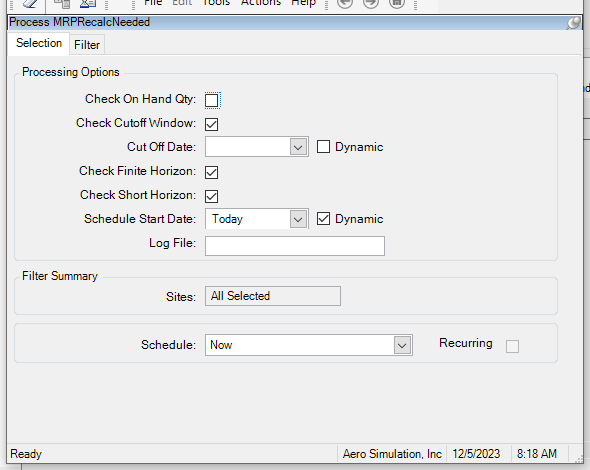

I have set up the MRP recalc to run right before the Net Suggestion Generation. However, this caused parts that we chose to remove from the suggestions to show back up and parts we really needed to purchase didn’t show. I ran the Net Suggestion Generation just for the parts we were missing and they did show up in the suggestions.
I am not sure I had the parameters for the MRP recalc set up right or what might cause these issues. I have turned the process sets off and the Full Regeneration on to run every night. I would prefer to have the net generation run during the week and a full regen on Sunday.
I have attached the settings for the MRP recalc as they currently exist. Would any of these settings be causing the issues we are seeing?
