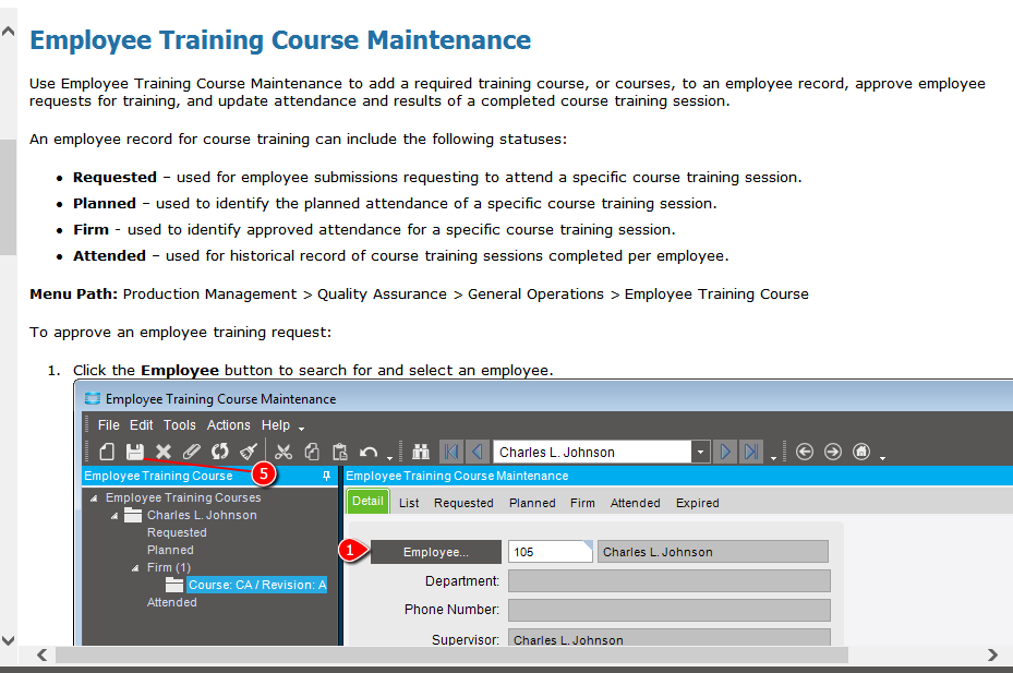

I was going to say look at the training course maintenance. What you described is all there. I can’t see on our license anything that refers to it by name, but we do have access to it. Perhaps it’s part of QualityAssurance – it’s only the base module we have, not Enhanced Quality or the external linked one.

It is part of the Quality Assurance module
It’s weird that I don’t have the menu items listed. I can make a custom menu item and pull up the program though, so I guess I’ll have to do that. That doesn’t make any sense…
I suppose I should read the warnings. You need the EQA license installed. We don’t have it.

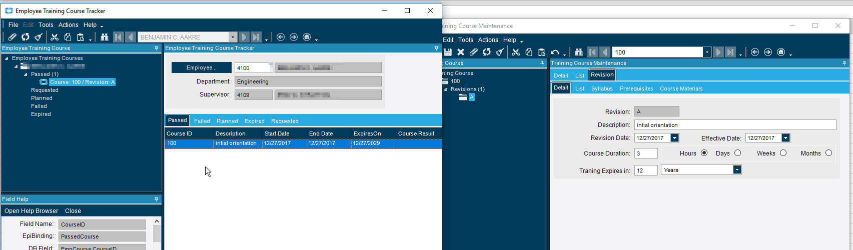

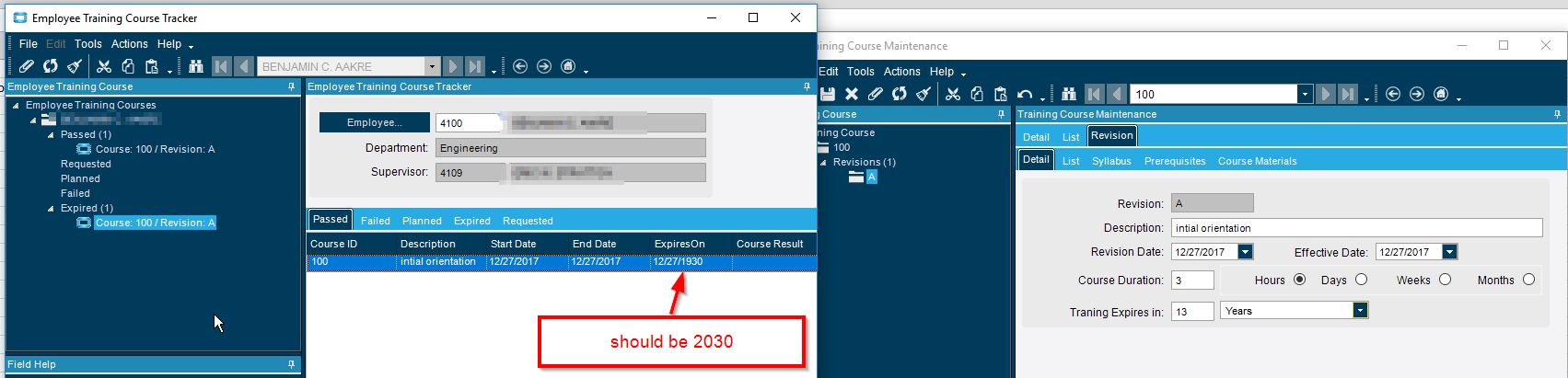

For anyone using the training did you notice that training that has an expiration date of longer than 12 years makes the year for the calculated expiration date go back to the early 1900’s?
