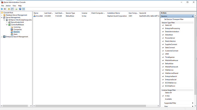

You might as well use the sessions in the admin console since you need to go in there to regen anyways.

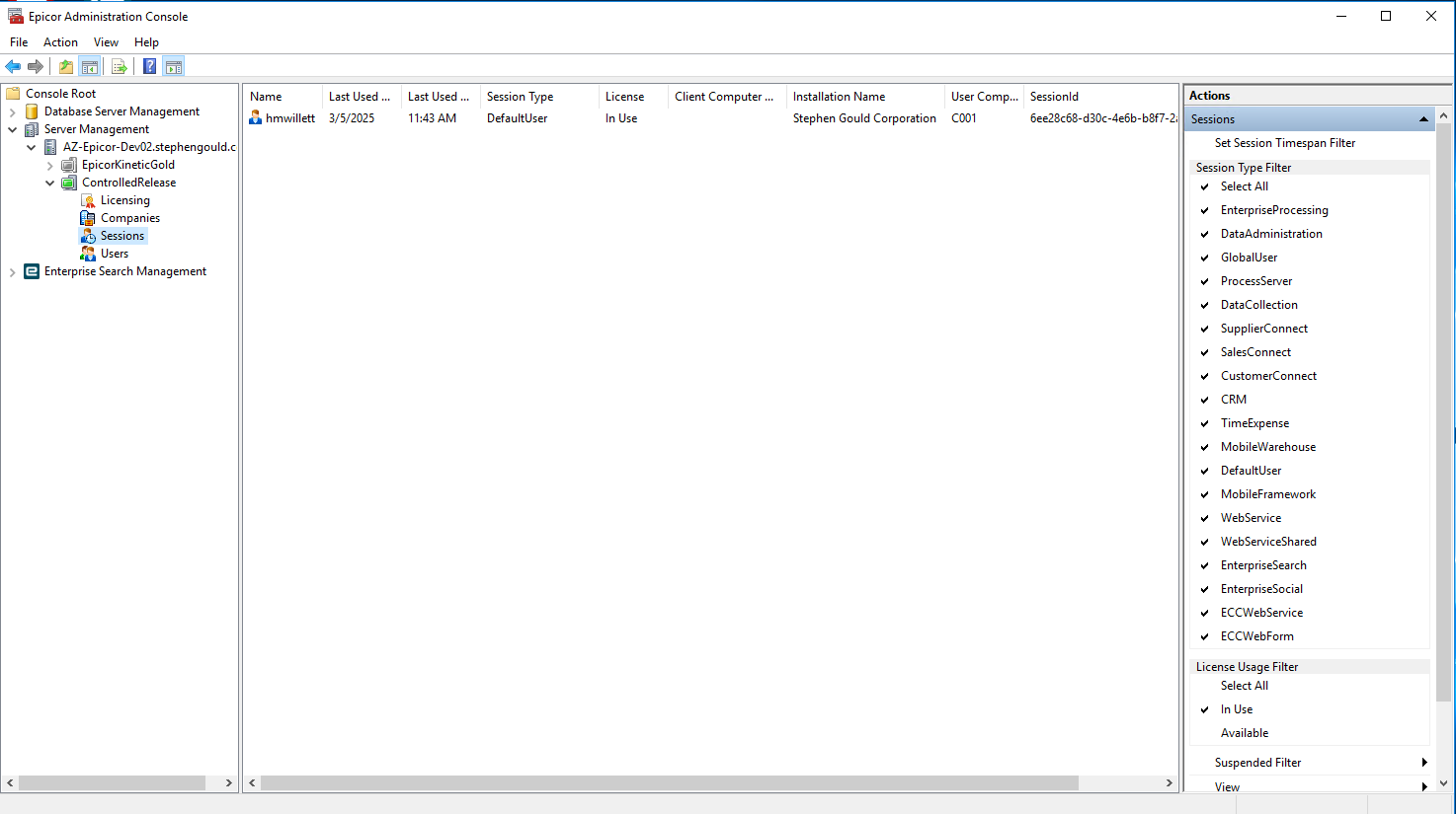

Only thing I don’t like about the EAC is the fact that when a session goes idle it does not show. So you have have heaps of people who have just walked away and left their rds sessions to think that Epicor will still be open when they come back the next day…And of course overnight the user sesson expires and there is a message to restart Epicor…
I know you can change the timeout, but the OCD in me just wishes that people would just logout of their RDS sessions (and as result close Epicor)…
