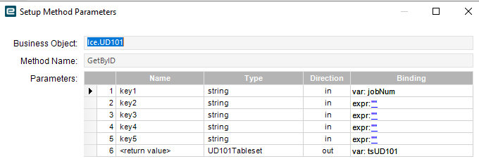

I have a function created:
Library: QAJobInspection
Function: GetBinNum
Input: jobNum (string)
Output: binNum (string)
The function, Invokes BO Method - Ice.UD101.GetByID → Set Argument/Variable: binNum to tsUD101UD101Row.ShortChar05
