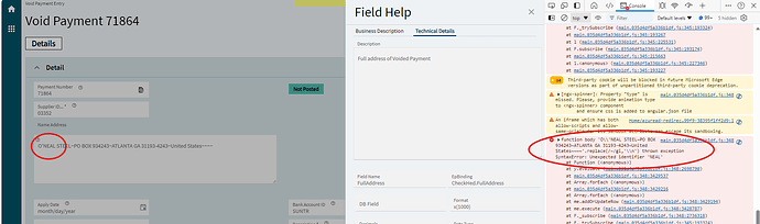

Fun fact: if you have an apostrophe in the name/address field of CheckHed, it then becomes impossible to void the check - in the browser. (Does work in classic.)
What happens is that every interactive control on the screen grays out (and the void button, though still blue, becomes unclickable).
I’ll be reporting this now.

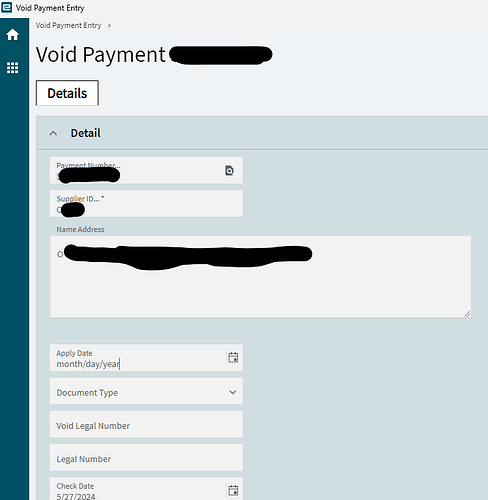

I see the same thing on our test instance of 2024.1.4. Everything except the navigation bar on the left of the screen and the address box in the form isn’t interactible. I’m patching up to .5 right now and will check to see if it’s the same.
Thank you - I appreciate it!

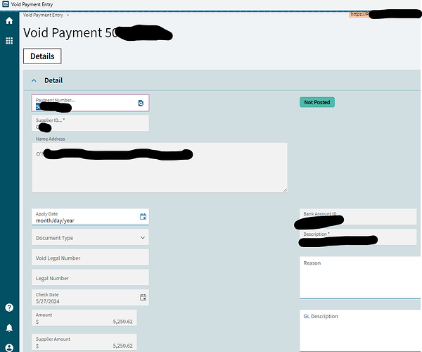

Slightly different symptoms on .5. I had to switch to using the client-embedded kinetic screen because I’m having issues logging in with browser, but when I pull up the payment, everything looks OK. The Apply Date and reason code are editable.
But then I click on Reason or Apply Date, the form processes something (marching ants at the top of the screen), then everything is disabled. I can’t even refresh the form or go to the landing page to pull up another payment.
