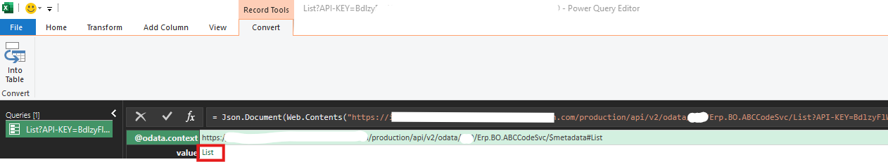

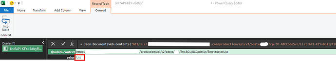

  3. You should see something like this (assuming you have already connected to Kinetic with your Organizational Account). Click on the “List” value to navigate to the result list
  4. Click on the “To Table” button to convert result to a table. Press Ok on dialog.
