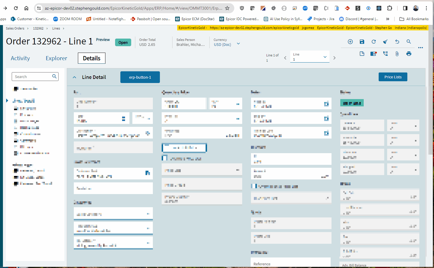

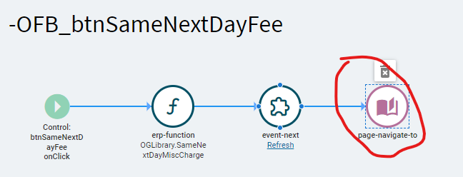

Have a straitforward event, want to navigate to Misc. Charges for Order Detail…
Event:
from the Application Map, OrderLine Msc Charges:
Seems obvious but does not navigate

First thing i think of, is that if the function is throwing an error or the Refresh event is throwing an error then it a lot of the time will prevent the next events from triggering. Have you already ran the program with dev tools open (F12) and then pressed ctrl+Alt+ 8 and ctrl+Alt+ 9, and seen if the page navigate is actually being called correctly?
Function runs fine, fully tested before I added the page-navigate
I did do the F12 tracing also, everything is as expected

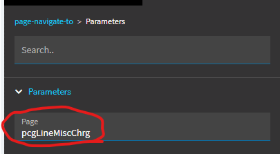

I’d set up a new button with just the navigate… see if it fires. Would help to make sure your settings are correct on that one step.
I tried that, then tried a couple of other pages,
first I tried “OrderRelDetailPage” (order release details) - didn’t work
then I tried “Details” (order header details) - this worked
so then I tried putting it back to “pcgLineMiscChrg” - didn’t work

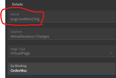

I’m pretty sure you can’t navigate to a virtual page because it ins’t in the DOM yet.
Well… “pcgLineMiscChrg” is a “Virtual Page”… not sure if that has something to do with it.
“Details” worked, as it should.
“OrderRelDetailPage” didn’t work… which is surprising since that is a TabPage.

Assuming Epicor used best practices. There should only be Parent → Children loaded in the dom. The Childrend of the Children would be lazy loaded once its parent is loaded.
So since OrderRel is a child of OrderLine on intial load only
OrderHed → OrderLine exists in the DOM
Then once you go to OrderLine it lazy loads it’s children. Again this would be my approach / best practice to not overload the dom. So I suspect from the Header you can only navigate one level down via the navigate widget.
You can even verify this by using the Share URL if you share URL from inside the Line Misc (or Order Rel)
https://<myEpicorServer>/EpicorKineticGold/Apps/ERP/Home/#/view/OMMT3001/Erp.UI.SalesOrderEntry?channelid=9f87a43d-e6cb-447f-b325-cfb75110c8c7&layerVersion=0&baseAppVersion=0&company=C001&site=038&pageId=pcgLineMiscChrg&pageChanged=true&KeyFields.OrderNum=132965
Notice the pageId says pcgLineMiscChrg but when you load the screen in kinetic it only takes you as far as the header.
