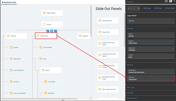

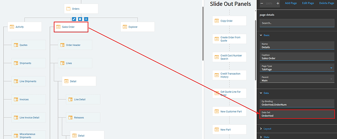

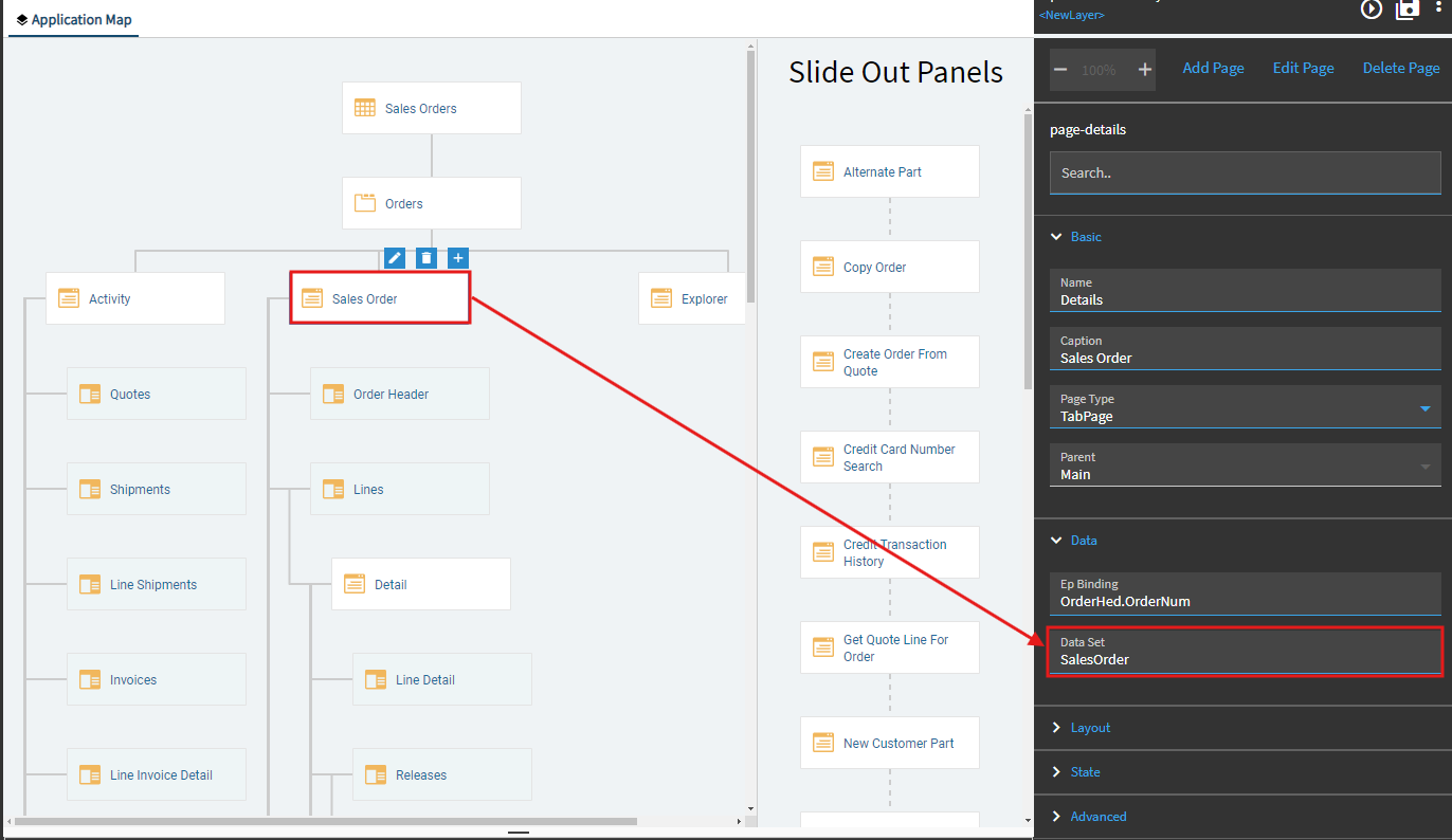

We ran into the same issue, following Mackenzie’s suggestion I took a peek at the base layer and compared it with our custom layer.
It’s silly, but all that was different was the data set under the Sales Order (Details) tab.
Base:
Custom Layer:

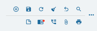

After making that change, we got all the icons back!
