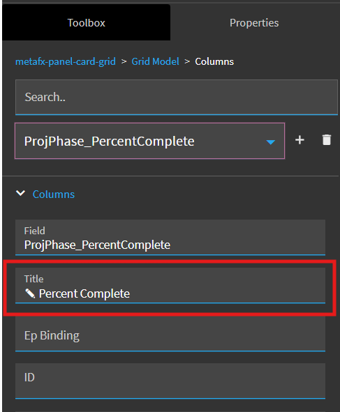

This is what I ended up doing… I kinda wish I could put a pencil icon in the column header.
:man_facepalming:
Duh Unicode… I can add a pencil to the column header title
That was easy… copy/paste it
or ✎
