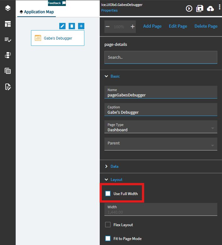

I have a Kinetic application studio Ice.UIDbd and need to set the application to open up maximized or change the width to be wider. Some of the fields in a grid are getting cut off because the application size isn’t large enough. I have tried all the options under the “Layout” of the app and nothing adjusts it. Do you know how to change this? Thanks.
In application studio, in application map, click on the root page (don’t hit the edit pencil, just get the properties to show on the right)
Navigate down the list and find “Use Full Width”
This won’t cause the window to open up full screen/maximized, but will let it scale to fill the space available when the user does so.

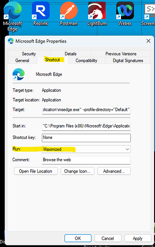

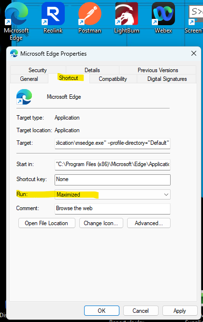

You can also right click the browser icon, and change the properties to run as maximized.
EDIT: Although this has worked for me in the past, it is not working with my Edge browser icon. :thinking:
Edit Edit: If you open the Edge Browser from a shortcut link, this approach my not work. However, when I set Edge as my default browser, and then put a shortcut (to Kinetic, for example), then when I open and maximize, it does remember the state after being closed. :person_shrugging:
