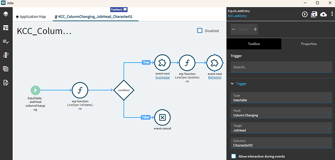

This is what I ended up with:
I used ColumnChanging trigger instead of ColumnChanged, for a number of reasons. I had started with ColumnChanged (out of ignorance), but when I reset the column at the end, it fired off another ColumnChanged event, which made me queasy that I could end up in the dreaded infinite loop, which could cause a black hole and civilization to collapse upon itself.
I named my event KCC_ColumnChanging_JobHead_Character01, triggered by the “changing” of that field.
  1. It calls the ValidateLine function, which returns ValidLineChange as a boolean. (This function also pops up the error message if it is invalid, so there is nothing left to be done after the routine if it failed validation.)
  2. The condition checks ValidLineChange:
  3. If false, we use the event-next event-cancel event (no need to reset the value).
  4. If true, we first write the buffer values to the db with SysUpdate.
  5. Then we call the UpdateLine function that does the magic of updating the JobHead, JobOper and JobOpDtl tables in response to the line change.
  6. Finally, we call the RefreshUI event to reload the buffer with the new db values.
Whew! It all works, and it only took me a few hundred iterations to get all my ducks in a row.
Once again, thank you to everyone. I really appreciate the help. I wanted to document the completed solution in hopes it may help someone else down the road.
