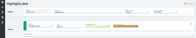

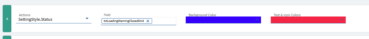

Hello,
That worked for setting a background color but the font color never changes, no matter what color I pick.
Any ideas?
Example pics below.
What I set the style to
What comes up when triggered.

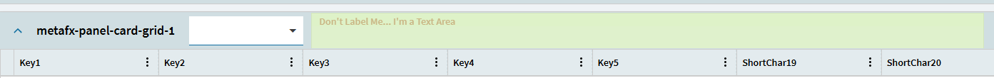

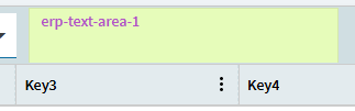

It MAY just be a muted color if the text area is set to read only, or disabled.
Wide Open:
Read-Only:
Subtle… but the colors are muted when the control is protected.
