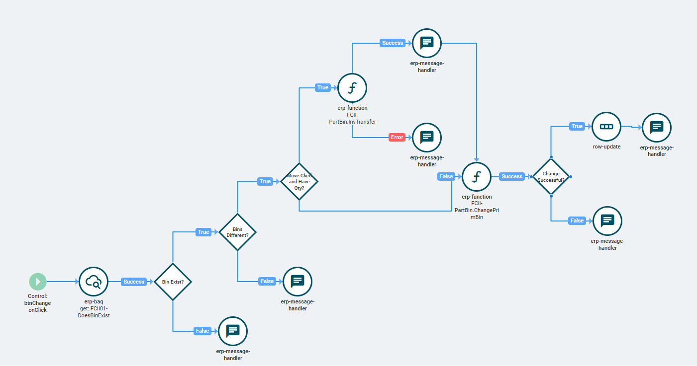

I have a working layer customization in our text environment. I went to copy it back into our production environment using export/import but found one of the event customizations come in wrong. I then did a simple “save as” staying in the test environment and it yields the exact mess up event. The working event looks like this.

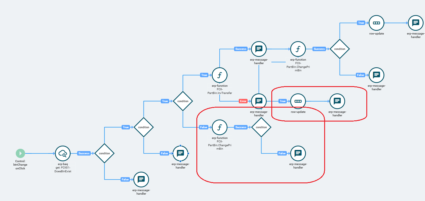

A “save as” or export/import yields this. The Condition Shape Labels disappear, but worse yet, it creates duplicate widgets and creates different interconnects. I’ve tried to clean it up, but the underlying code that executes does not match what I’ve cleaned it up to be. I’ve created a case with Epicor, but they haven’t responded yet.,

Great idea, but unfortunately, same result.

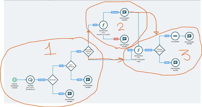

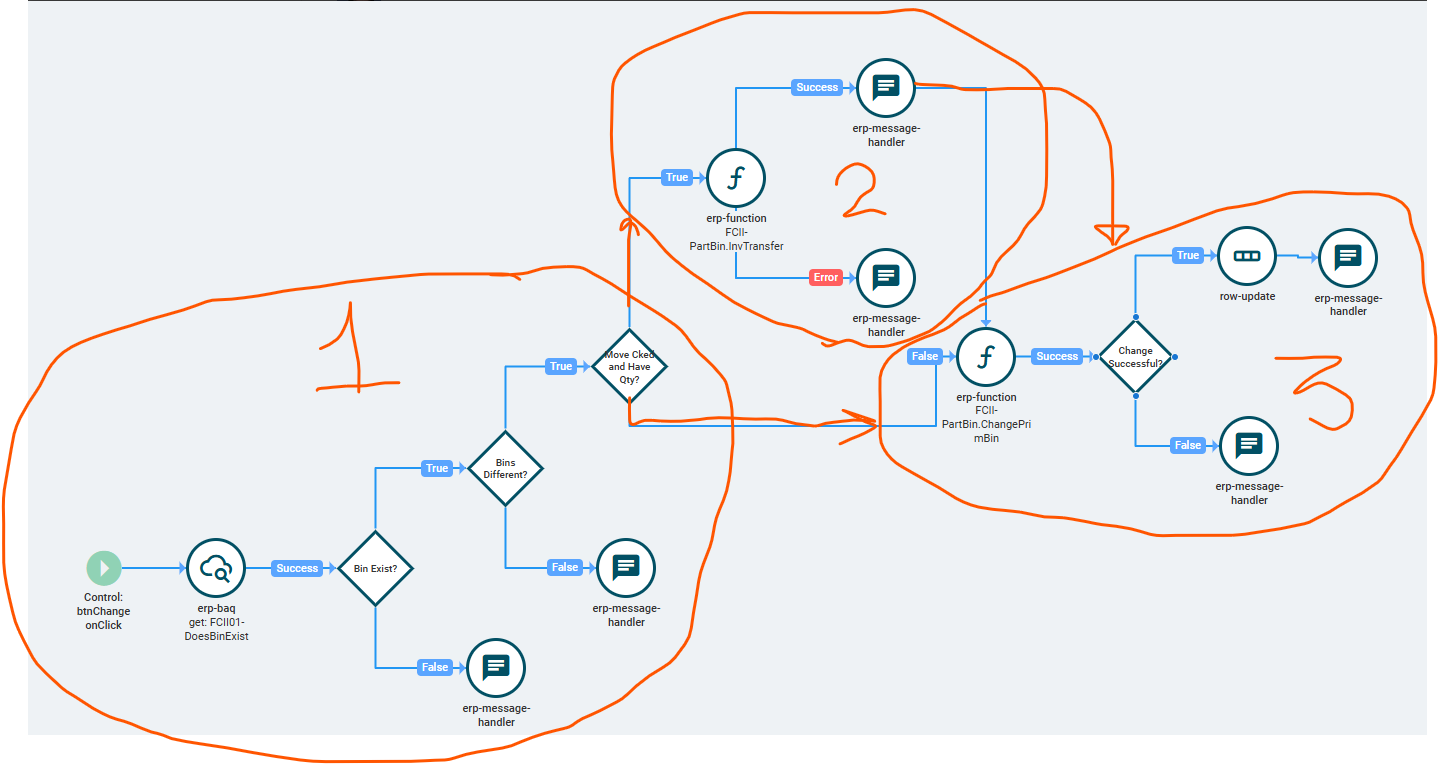

Could be wrong but last time i looked at the json, there’s no connectors collection to be found. in other words it’s just a nested array of actions. you cannot ensure an action will fire after another just because you drew a line between. theres no way for the json to model an action with two points of entry.
thats why it split at and duplicated your function.
the pretty diagram isnt doing what we think its doing. if you want to go the same place on two paths split event and call that place from both.
EDIT: so 3 events like this (orange arrows are event-next actions):
