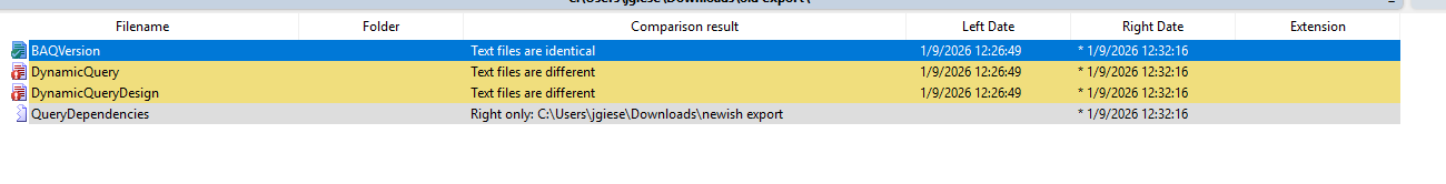

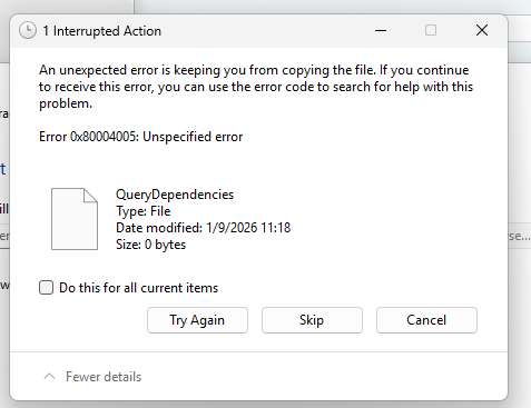

So interestingly… I can’t successfully unpack your original export. I imported it into my system and exported and that I could unpackage. Your copy above I get this trying to unpack
What version are you on? Its probably not backward compatible?
I exported the same version as you no mismatch there.

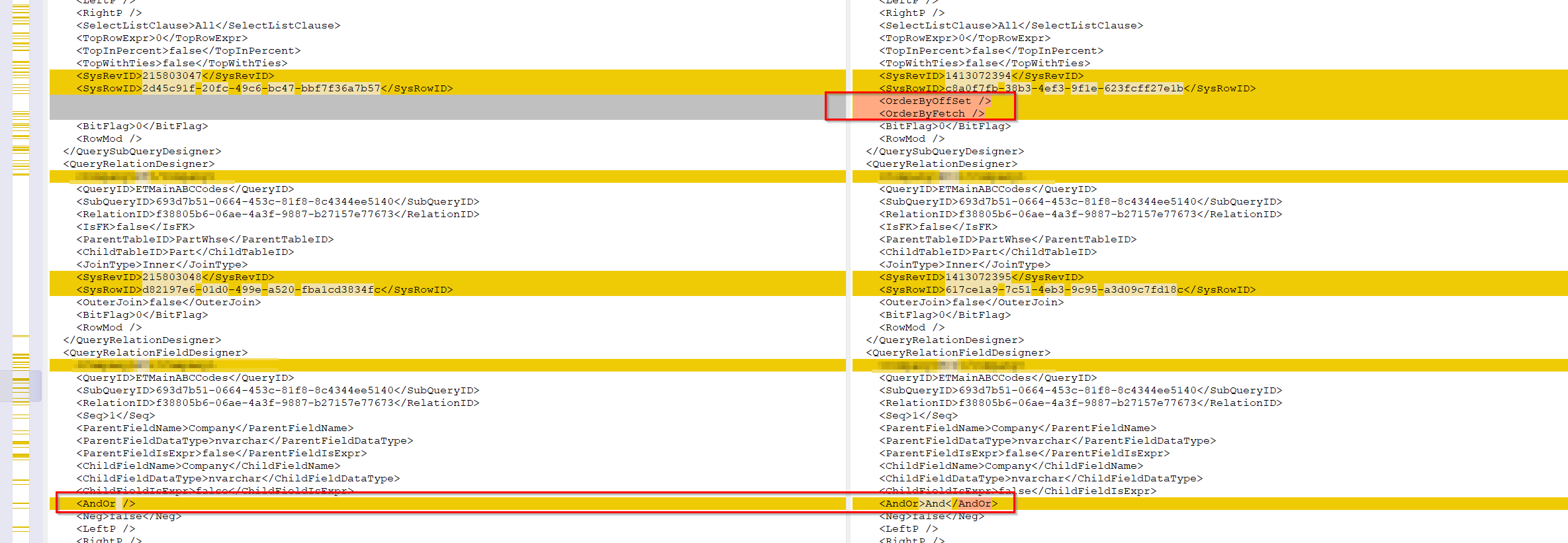

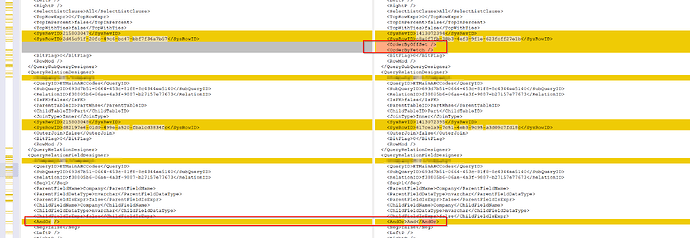

I did find in your export the and/or for the relationship is empty but my export it came out with “and”
I suspect a UI bug is breaking that part and it’s self correcting on import/export
Yep, I suspect that too.
It is self-correcting on running and it does not change any significant field on export/import at all.
