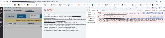

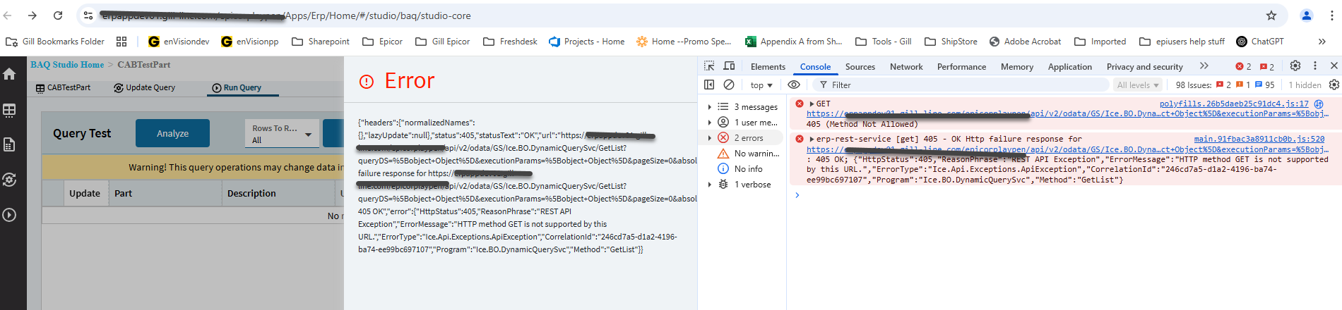

When I test it in that version, I only see one error in the console.log and then results are returned, as they are supposed to,
Also when I test it I see only one error in the log,
and in your case there are 2 calls with errors, and I cannot explain it.

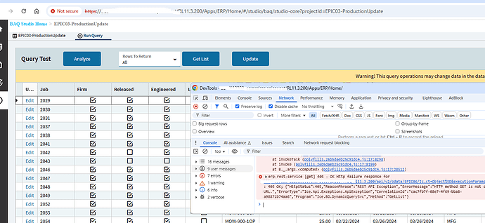

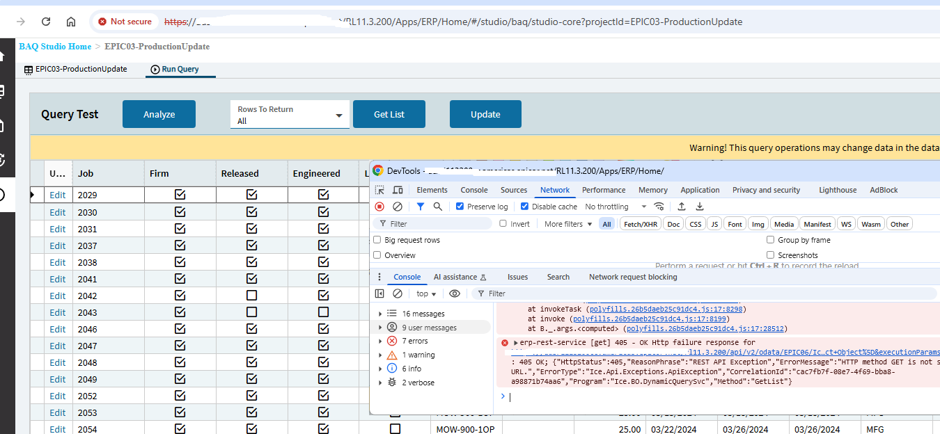

Very interesting Olga. I hadn’t noticed there were 2 calls. Here’s our screen shot and indeed no results are returned.
well, probably depends on browser. I see one error in Chrome and 2 in Edge, but in both cases result is returned… :woman_shrugging:
Sadly I get the same result (2 errors - no results) in both Chrome and Edge, as well as running BAQ Studio launched from the client. We had a workshop internally yesterday and all 5 of us created our own ubaq and experienced the same issue. And I get the same result with a ubaq created in the Epicor Demo environment in the EPIC06 company (installed beside our test environment). I’m at a loss of where to look. We have no modifications to the host.config and the only modification to the sysconfig.json is to enable the ep.metafx debug. Whenever I do a major upgrade I always wipe and replace the app slot on the server so I don’t carry over any residue. I use the same process when I update production.
