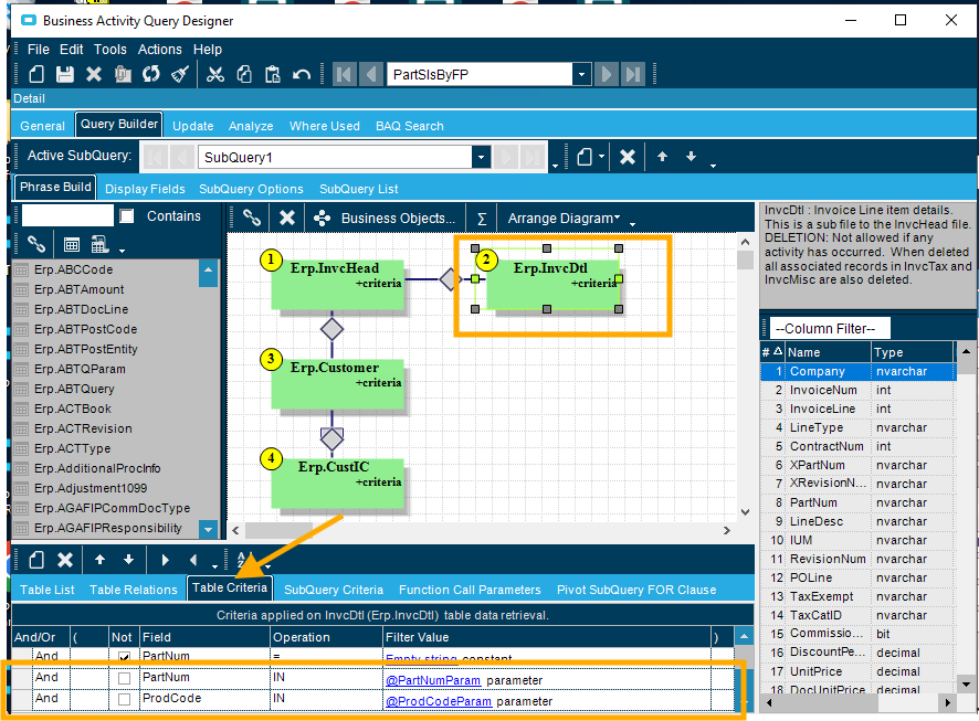

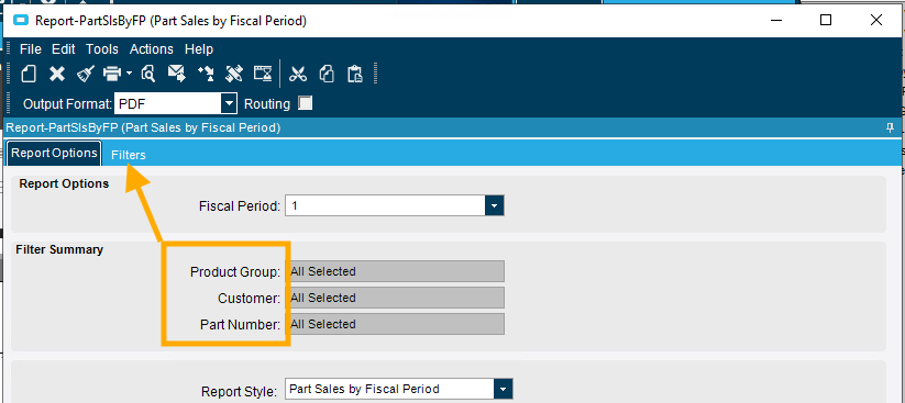

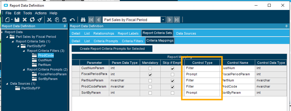

I was able to figure out on how to utilize Filters of a Report Style that’s based on RDD that runs on a simple BAQ.
My BAQ has parameters for Product Group, Customer and Part Number.
In the RDD they are linked to Criteria Set’s Filters as opposed to Fiscal Period which is a Prompt.
Back in my BAQ, those parameters are set in appropriate Table Criteria with the IN Operation.

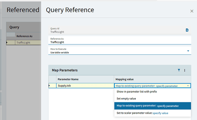

The new Kinetic BAQ builder allows you to reference other queries but doesn’t seem to accommodate the use of parameters. Perhaps I’ll punt on that approach and try my hand at making it work within SSRS.
It does allow for parameters, it’s in the overflow menu.

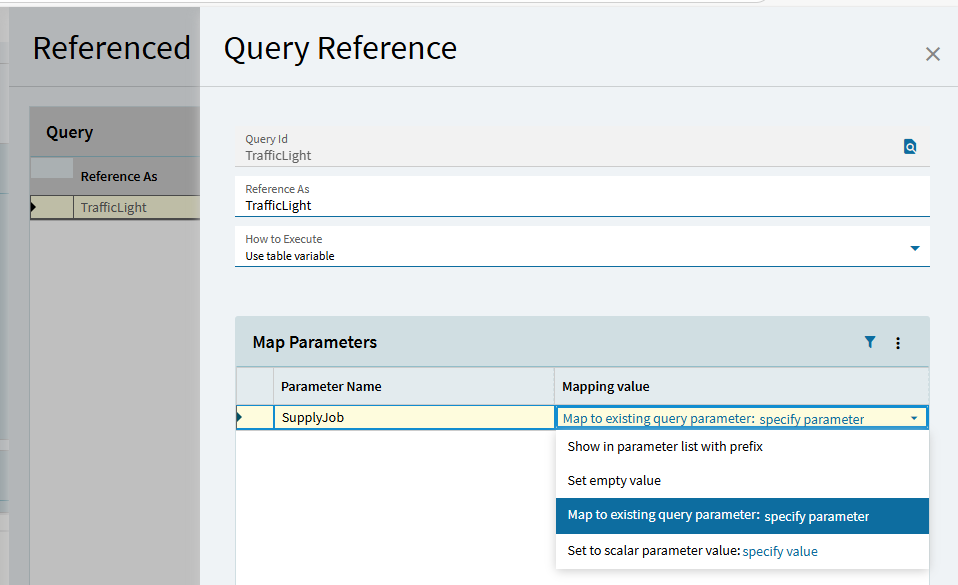

I don’t see parameters as an option for referenced subqueries though. Can you give a screencap of what you see? I may be missing it.
You define subqueries for the overall BAQ and then you can use them wherever.
My problem is that I don’t need a parameter for the top level query, but my referenced CTE query requries one. I’m trying to pass a field from the top query to the referenced CTE query as its parameter.
Here’s the only options I’m presented with:

There is no way to link a field.
The way it executes - first the referenced query are executed, and put their result into temp-table (or similar).
Then the current query is executed using the data from that temporary storage.
So it is not possible to use the field value from the query that is not executed yet.
