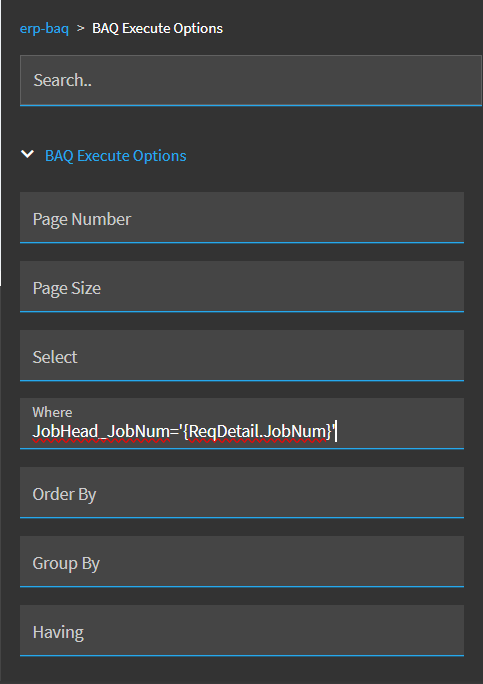

I am trying to send data to a BAQ with a subquery but I can’t seem to filter the BAQ at the top level by the values I have. I have done this successfully with a plain BAQ (no subqueries) by setting erp-baq > BAQ Execute Options > Where JobHead_JobNum = ‘{ReqDetail.JobNum}’
The BAQ this is referring to joins JobHead and Project so the JobHead_JobNum seems to correspond to the JobHead table and JobNum field.

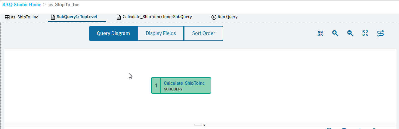

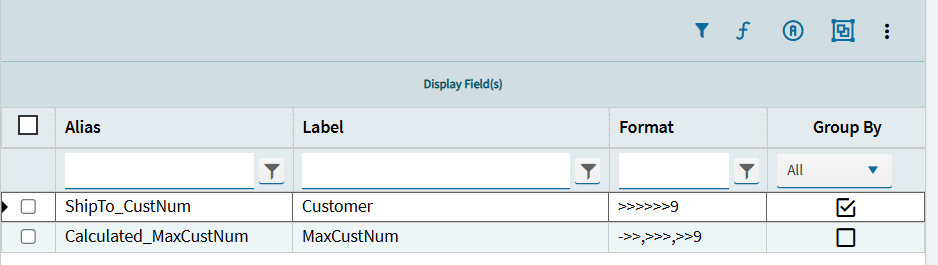

My current BAQ I am trying to make work does the math in the subquery and at the top level, groups by the CustNum and finds the maximum value. I want that maximum value. I have a button used to test this BAQ query and displays the value in the dataview that is supposed to be populated but it always returns undefined.
Top Level BAQ
Top Level Display fields

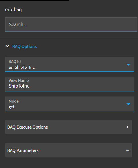

Application Studio BAQ Widget
I have tried removing the quotes in the last screenshot but no change. I have also tried addind Calculate_ShipToInc.ShipTo_CustNum in the WHERE clause but I didn’t see any change.

The question mark notation actually (frustratingly) does not work with the BAQ widget’s Execute Options. RIP.
That’s, indeed, how it should be.
ShipTo_CustNum = {Customer.CustNum}
I would hook your widget up to a button and monitor Dev Tools to see what it’s passing in the payload.
(Strings will be wrapped in single quotes)
