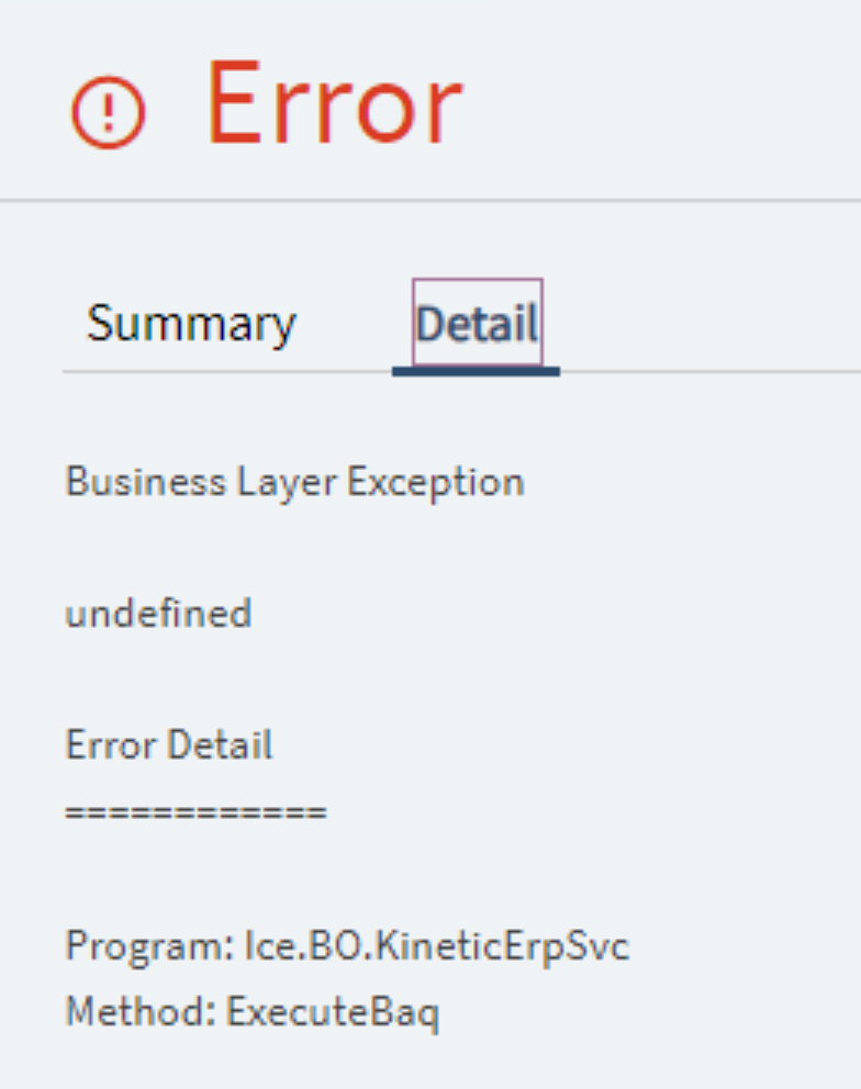

I get this super helpful error message.

try to open DevTools console window and check red messages there. It must be more descriptive. Undefined just means that error message does not correspond any expecting format and panel cannot show it correctly.
I deleted the broken versions out of frustration, but I can re-create them and try that to see if the error at least provides better details.
I wasn’t really griping all that much about the error message itself as my lack of understanding how the different flavors of bindings are intended to work.
It may be not even related for your changes.
Personally I often get this message when auth token is expired and client cannot connect to server. Server returns 401 error in that case, but client has troubles to process it correctly and switch back to login page.

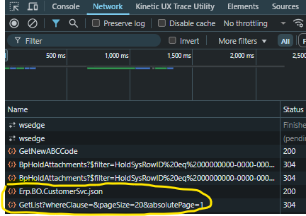

The provider model actually performs the call, returns my GetList:

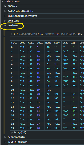

… creates a “Customer” DataView, and populates it with the returned values:

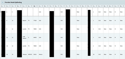

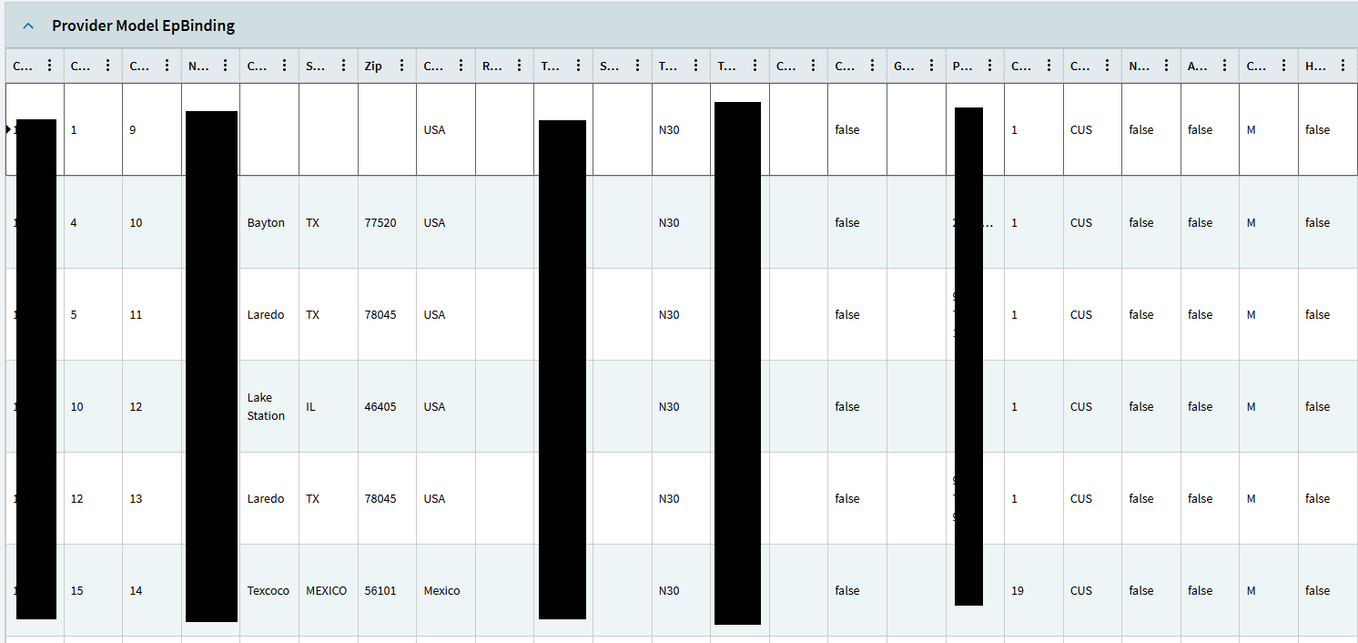

Those values then populate in the grid:

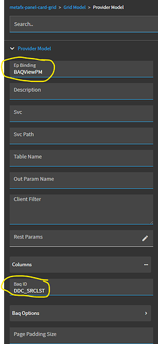

But I defined it in my Grid Model Binding…
I then told the Provider what BAQ to use…

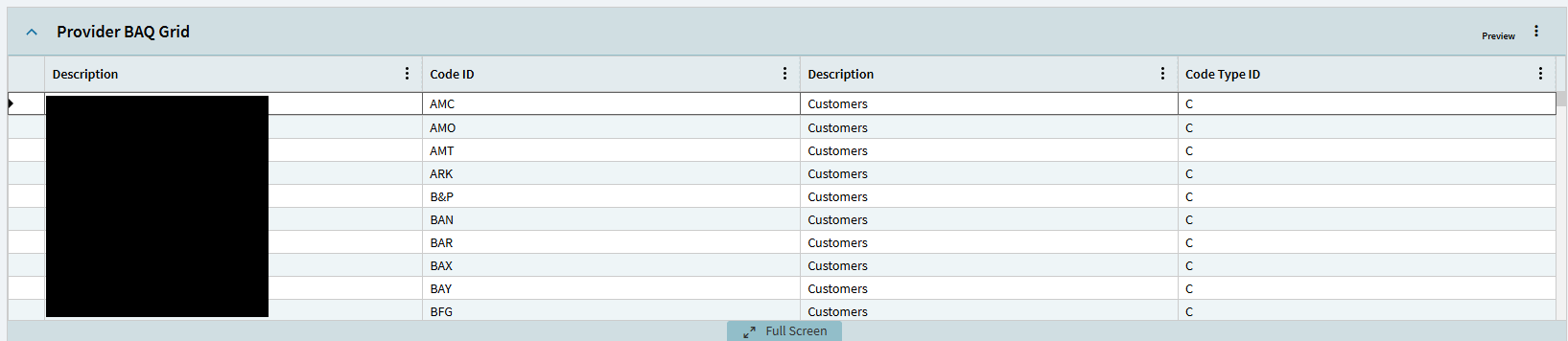

It automatically added and filled the DataView…
And my grid populated with the data.

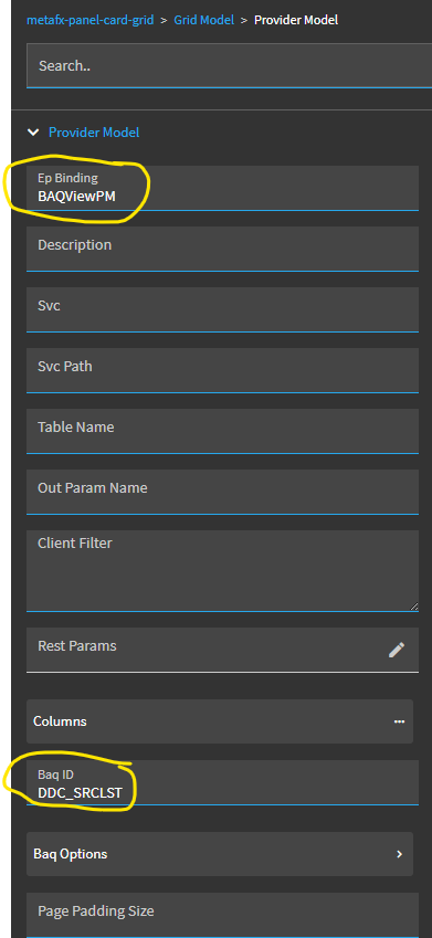

I did this one again, but set the Provider Model EpBinding instead… and it worked that way as well.
In fact… I never deleted the EpBinding in the Grod Model… I just added the BAQViewPM to the provider model binding and it used that one instead.
