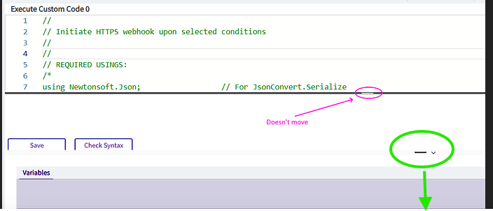

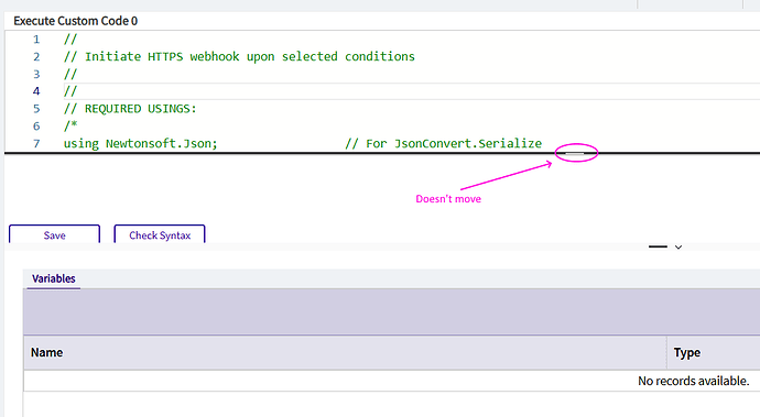

When I try to edit a Custom Code block in a data directive, the editor in Kinetic browser 2025.1.11 will only show 7 lines of code. There doesn’t seem to be a way to get a full-screen editor, or am I missing something?
Try this…

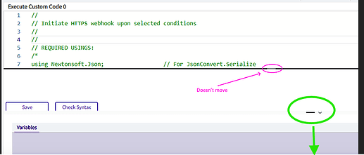

First, click and drag the bottom pain divider down to give yourself more space on the page. (circled in green below).
Then… Double-click on the upper divider, on the item you circled in your picture… then try to drag it down.
Thanks but already tried that. Even with the bottom pane pushed almost off the bottom of the screen, the editor pane will not expand beyond 7 lines. (This is in plain ol’ Google Chrome.)

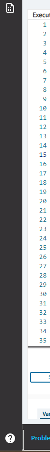

I was able to get up to 35 lines by doing this:
Ok, that makes no sense - why is your Chrome better than my Chrome!? :slight_smile:
I still don’t know why I have to double-click it in order for it to work. After doing that, I can move it up and down as it was intended. :thinking:
I agree, doesn’t make much sense why it works for me and not you.
I’m also using 2025.1.11
Just tried it in Edge browser… I didn’t have to double-click… if I drag the bottom pain down, the upper pain automatically got larger to take up the space.

Doh, I completely missed the ‘double-click’. Yea, that works now, although I can only get about 26 lines to show (seems to depend on screen resolution).
Still, this seems an incredibly weak replacement for a full-screen editor.

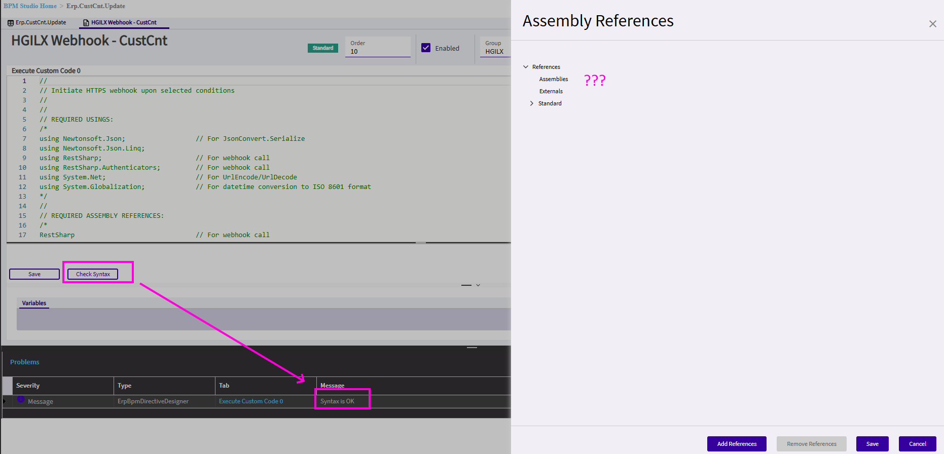

If I am editing a custom code object in Kinetic BPM Studio, and I add new code that requires an additional assembly reference, then I can add the assembly reference with the 3-dot menu and ‘Save’ on that slideout. But if I now hit ‘Check Syntax’ I still get the same errors as if I had never added the assembly.
Similar thing happens if remove an assembly that the code requires, then do ‘Check Syntax’: it will says ‘Syntax OK’ even though the assembly reference is no longer present.

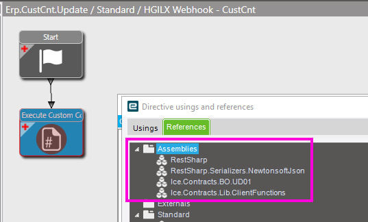

Even worse, going in and out of a BPM seems to confuse the app. Here is the same BPM at the same time being shown in Classic and Kinetic. In Classic you see the assembly references; in Kinetic, they don’t even appear (at right), and yet ‘Check Syntax’ says its all good, so behind the scenes the Kinetic app “knows” the assemblies are present:

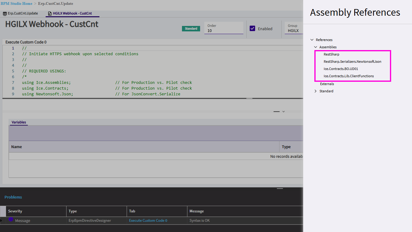

If I close the BPM Studio app tab in the browser and open it from the menu again, then magically the assembly references now show:
So steps are: 1. Open References, Add one, close.
2. Open again, it is empty? or not?
