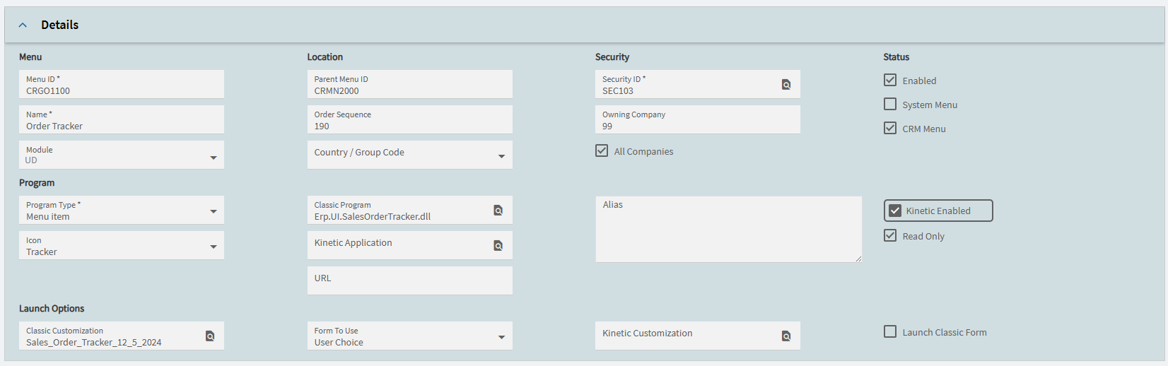

These are the options displayed for Order Tracker in Menu Maintenance:

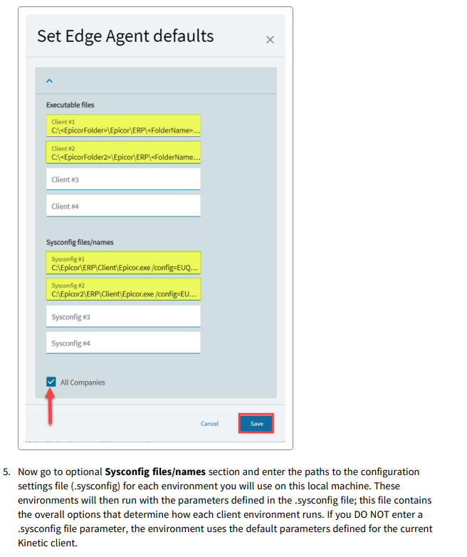

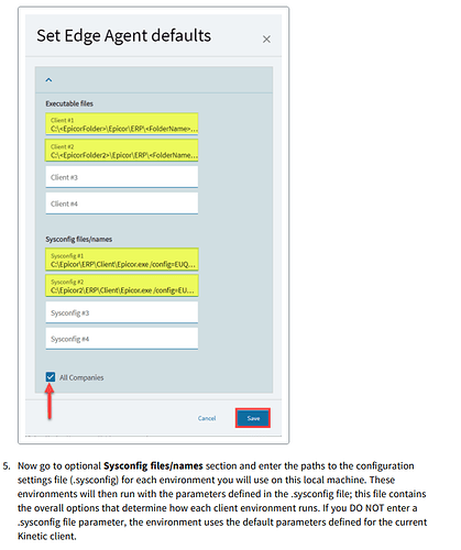

What version of Kinetic are you going to in the cloud? In the 2024.2 version of Kinetic, the corelating version of Edge Agent requires you to configure a path to the smart client so that it knows where to pull the .dll from.
It’s separate from the app server urls that it uses for print communication.
Image from the 2024.2 upgrade guide:

I took the screenshot from my Kinetic 2024.2 upgrade guide that I used earlier in the year when we upgraded. You can get the corelating upgrade guide for your version of Kinetic from EpicWeb; as I know there were additional upgrades to Edge Agent for the 2025 versions (like Edge Agent being updatable, as opposed to having to be uninstalled and a new version installed with each Kinetic Upgrade).
