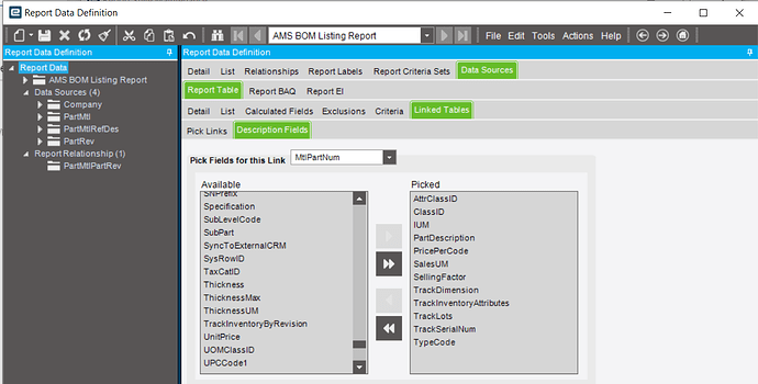

I have added a linked table and some fields within a standard Epicor RDD (after duplicating it), the below is the linked table and field selection.
When I try to edit the SSRS report that this produces it says it doe not recognise the fields.
