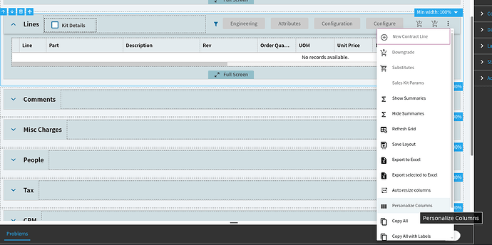

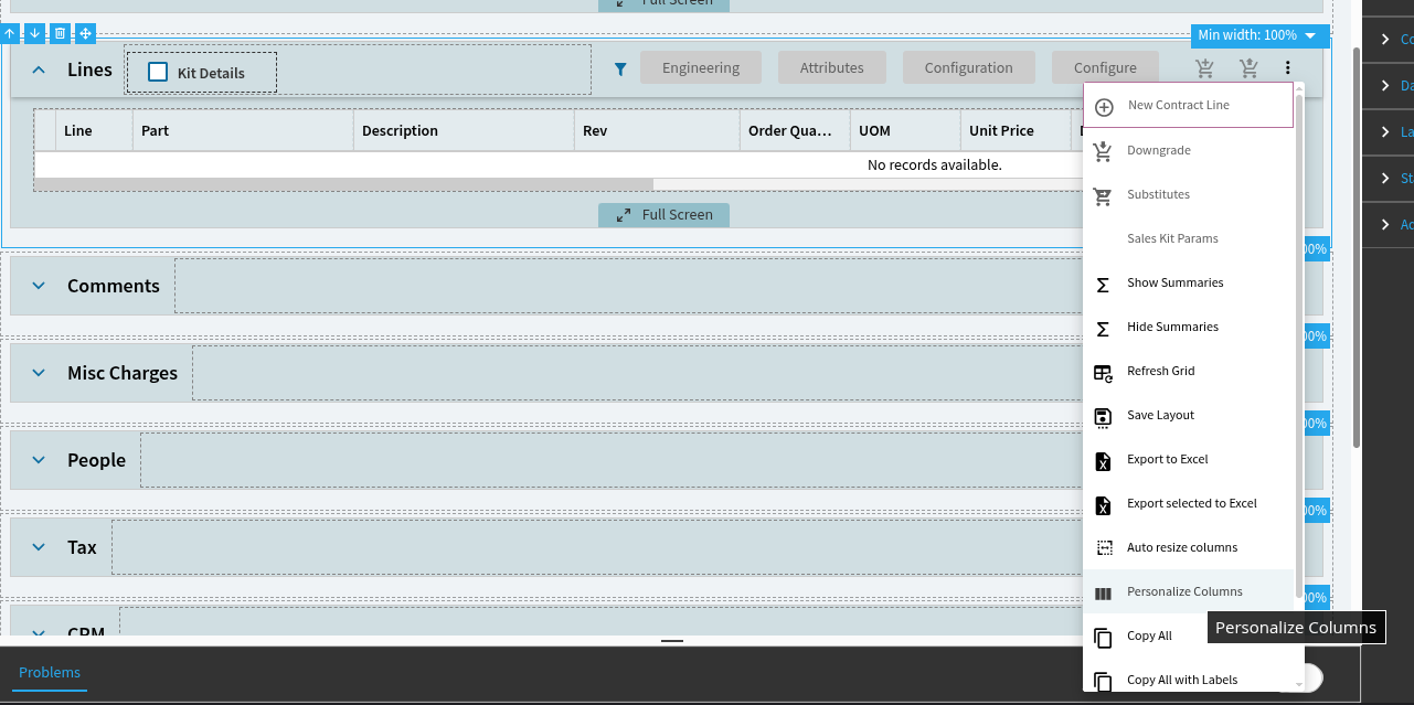

In App Studio, go to the Panel Card Grid, select the Three Dots > Personalize Columns:

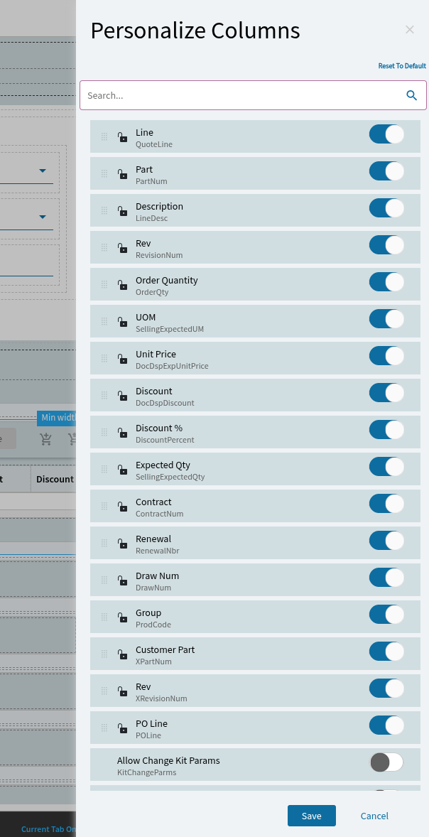

Enable, disable, move columns that are wanted, then Save:

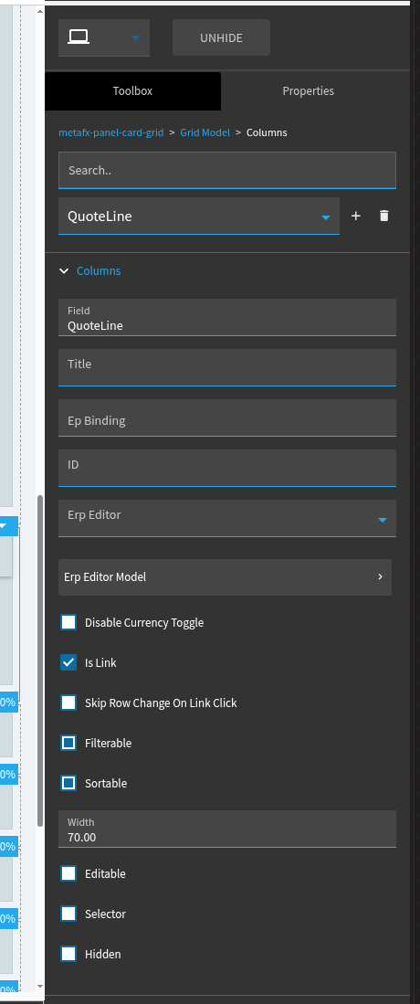

That’s normally what we do at least. Second and more drastic method is to go to Grid Model > Columns and delete all columns and manually add in the order you want them in. Rare that I’ve had to do this, but I have.

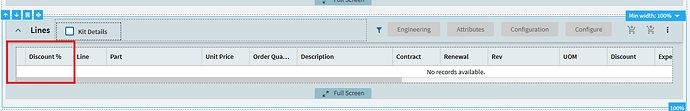

I tried the first solution. I personalized the column order in App Studio (Discount% was moved to the first spot) and published the layer:

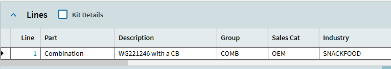

It looks fine when I preview it but when I refresh Quote Entry, the column order does not get modified:
I tried to log out/log back in but still the column order does not modified.
I checked menu maintenance and the layer is correctly selected in the Kinetic Customization field.

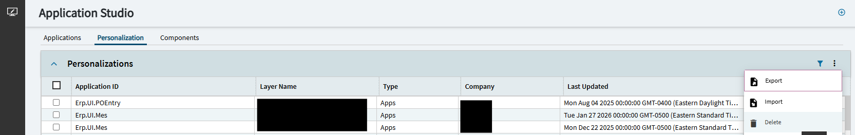

I have had this issued where an updated application conflicts with a personalization. I used Hannah’s tool to remove the personalization and then everything was good! :slight_smile: Need votes for a program to remove kinetic personalizations - Kinetic ERP - Epicor User Help Forum
+1. You can also go to App Studio > Personalization and find them there to delete
When did they add this functionality? It is not available in my verion.
I am not sure on the exact version, but it was somewhat recent. I was happy to see it. We are on 2025.2.10.
That was it, it works fine now. Thank you guys for your help.
