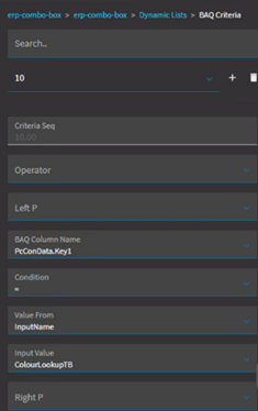

No matter what approach we try, the dependent combos never filter correctly. They always show all possible values instead of the filtered subset. It seems like the parameter (selected Part) is not being passed to the other combo’s data source, or the refresh isn’t firing as expected.
What we’ve tried so far:

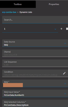

  1. BAQ-based dynamic list
  • Set criteria in the BAQ.
  • Called Refresh.DynamicList("ComboName").
  • Result: List loads, but not filtered – it still shows all values.

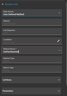

  1. User-Defined Method (UDM)
  • Passed the selected Part as a parameter.
  • In the dynamic list condition, checked that Inputs.PartNumber.Value is not null/empty.
  • Result: The list loads, but again, no filtering happens.

BAQ Method- Property:

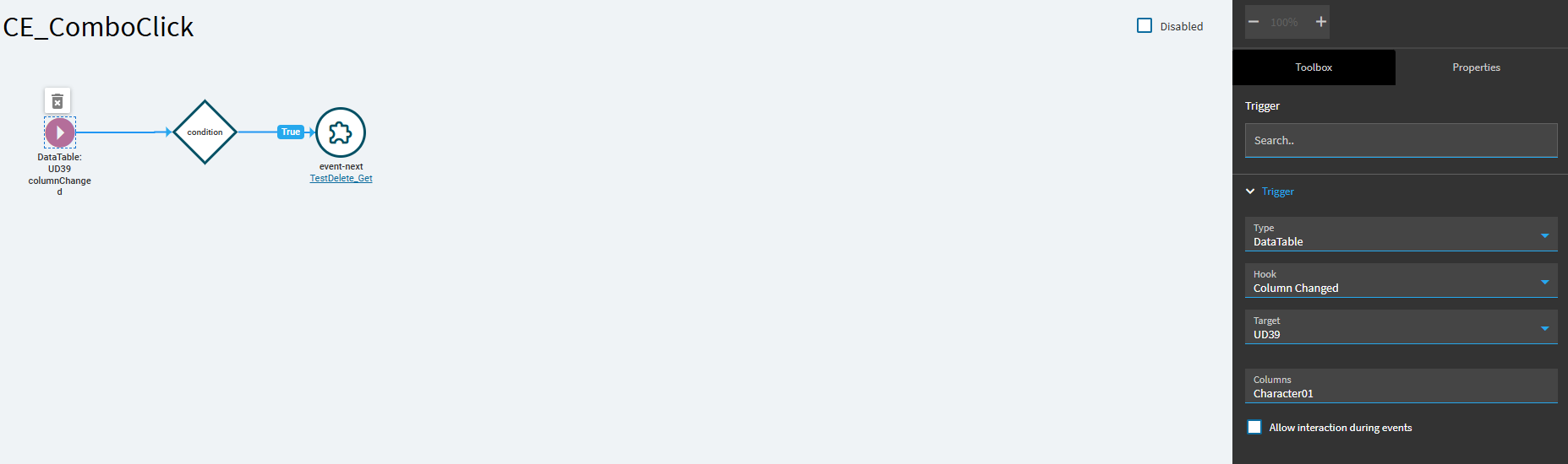

UD Method:
Question:

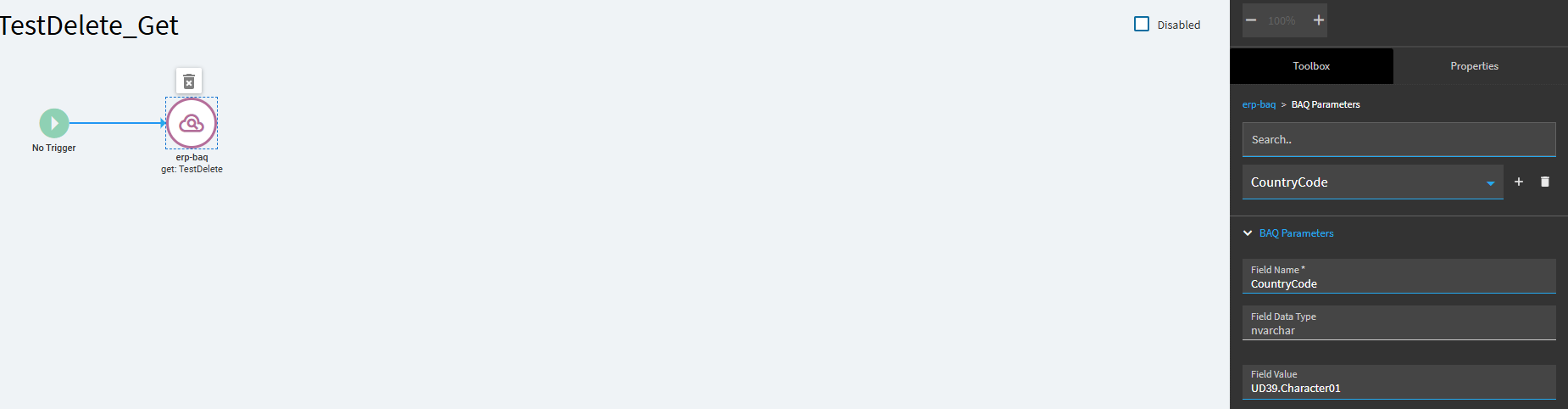

I think you can achieve this using a parameterized BAQ. Here’s the approach:
  1. First, let the first combo box populate as usual.
  2. Create an event on the ColumnChanged of that field.
  3. In that event, call the parameterized BAQ and pass the value from the first combo box into the BAQ parameter (using the binding of the first combo box).
  4. Make sure you’ve created a DataView for that BAQ.

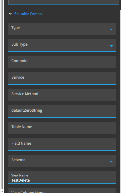

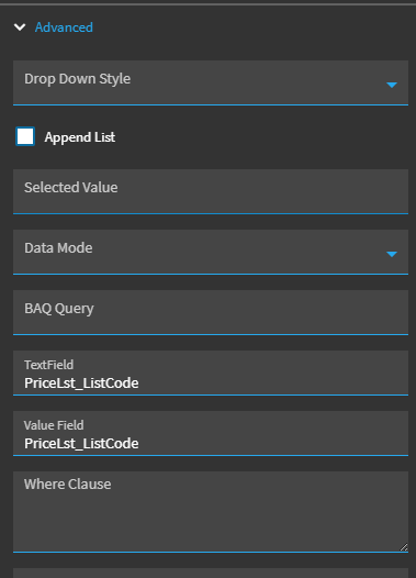

  5. In the second combo box, set the View Name field to the DataView you just created. Under Advanced, configure the Text Field and Value Field to reference your BAQ fields (see screenshot attached).
Additionally, you can add a data rule or another event to keep the second combo box disabled until the first combo box has a value.
Thanks for your efforts to help me,

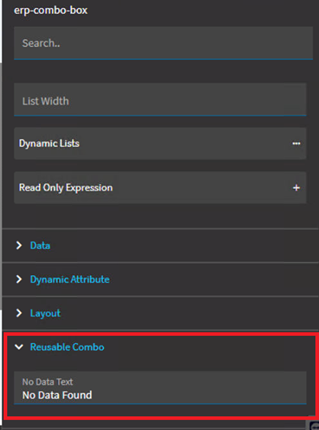

unfortunately, in this version we dont even have any options for declaring dataview values,
reusable combo section dont have any such options. its just empty
