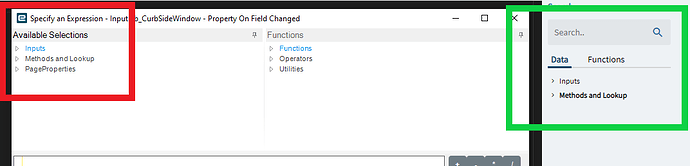

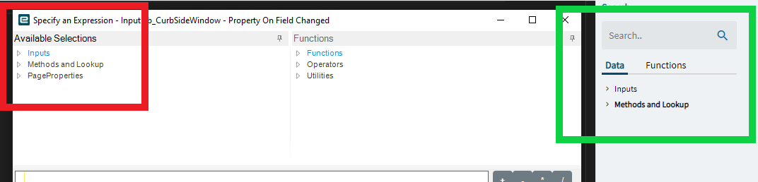

I am guessing page options are not currently functioning properly in Kinietic configurator. We are on 2023.1.7 in test. I don’t even have it as an option I can define see image below. Red is c-sharp options in classic and green is Kinetic.
