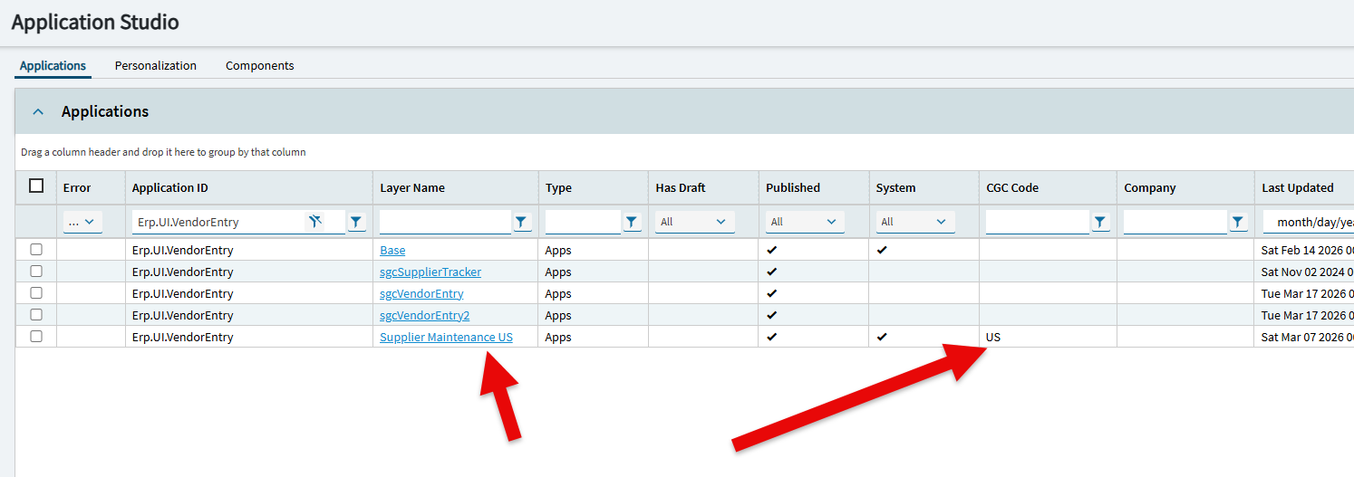

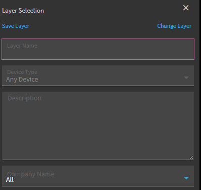

We have the USA CSF and we have some customizations on top of it. In Kinetic when we go create a Layer USA isn’t there at all but it does show up when we run the Screen so it must be … somehwere?
Is it its own Layer? if so how do I / we customize it?
One of our Engineers just re-buit the whole thing inside a layer in our customiztion but that can’t possibly be right.

After some investigation and conversations it isn’t really possible today to customize CSF Layers in Kinetic without doing some astounding amount of gymnastics.
C’est La Vie
There is an enhancement ticket that will hopefully make this possible in the future.

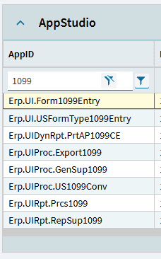

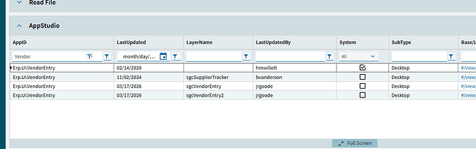

Try my Dev Tools dashboard, CSF editing should work here.
USA stuff doesn’t have a CSF** prefix from what I remember:

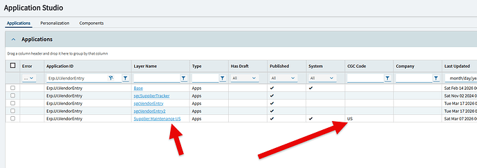

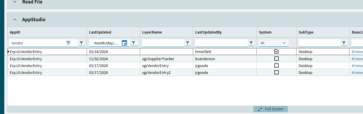

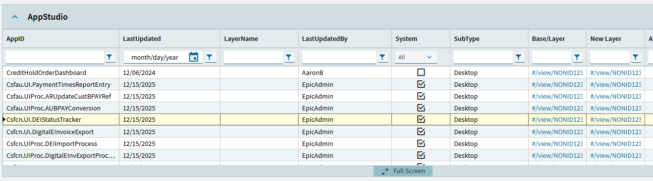

Well in Supplier Entry its a Layer Flaged as as System and it isn’t showing up in your Dev toosl it doesn’t look like it returns back from the GetApplications call for some reason
its this guy but it doensn’t show up in your Dev Tools at least I couldn’t find it
Or is this something all together different?
Bigger issue is even if I do manage to open that in App Studio I still can’t see / edit the USA card.
