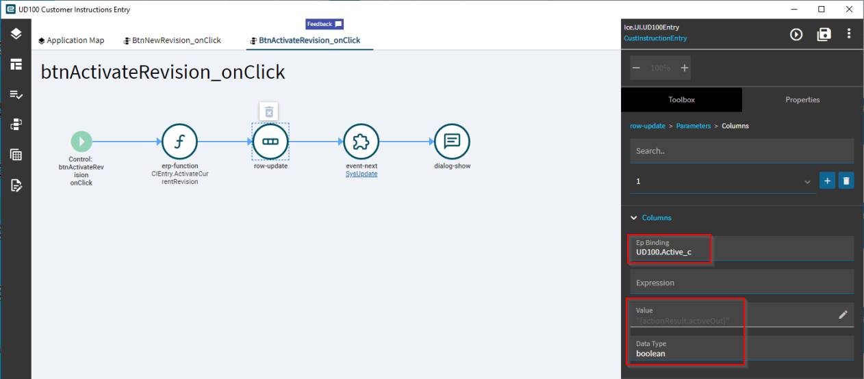

I have a boolean value coming back from a function and I’m trying to assign it to a UD field on UD100.
Here’s the setup in the customization:

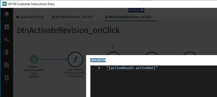

And a detail of the JSON field:

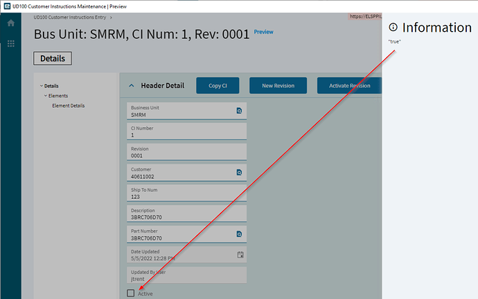

The UD100 field isn’t getting set, but if I show the returned value in a dialog box, I get its value:
What’s the magic here?

Try not putting a data type of boolean in. I have a few examples that work and none of them have a datatype.

I just figured that out. I had only put the type there because I was getting some error and it stopped giving me the error when I selected the type. I must have done something else wrong, too.
