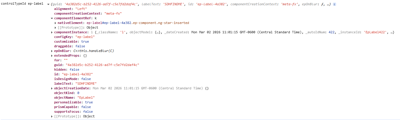

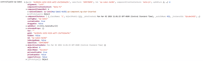

I am getting closer.
Here is what I see.
Where would I find the list of properties I can change for this Label?
I assume I can reference this label by id: ep-label-4a382, correct?
Thanks for getting me closer, I hope I haven’t been too much trouble.

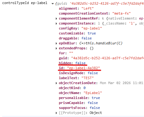

Hello,
I finally puzzled out that either some of the properties are showing in the picture in the last post or that is all you can change. Not sure which.
But I was able to hide and unhide the label using the Id shown and the property of hidden = false, then hidden = true in the property-set events.
