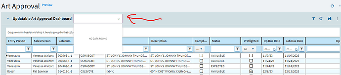

Have an updatable dashboard in Kinetic web, looks like this:

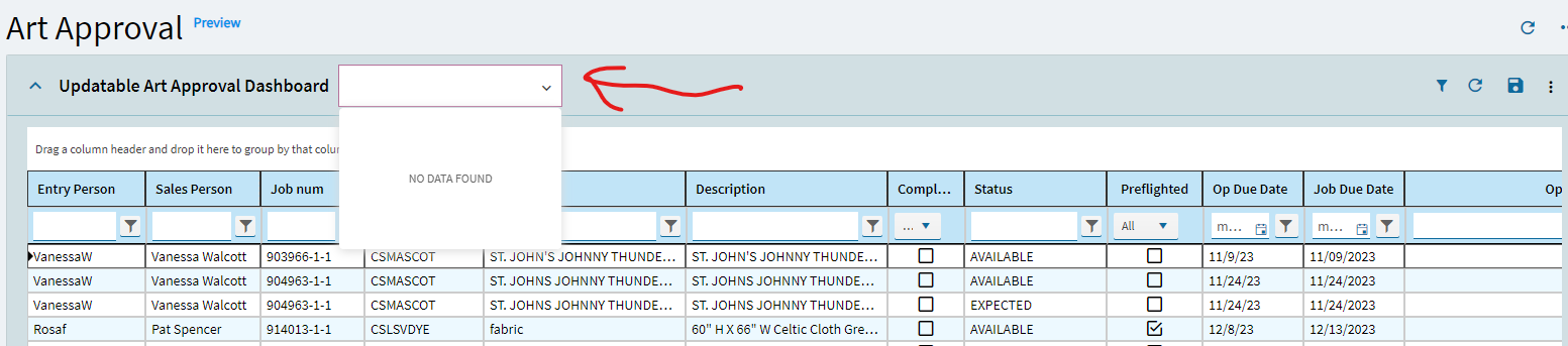

Multiple times now, after editing my layer an unwanted combobox shows up at the top of the panel area, looks like this:

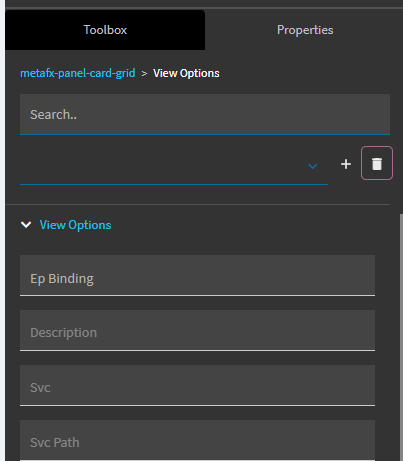

If you click on the Panel Card Grid > Properties > Advanced > View Options… anything fishy in there?
Yeah, I thought of those, but the whole section is completely empty

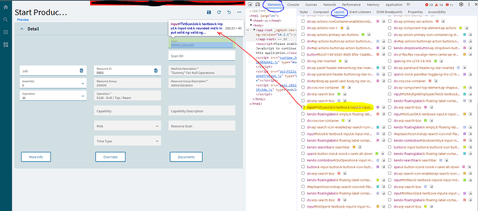

Another thing you could try which may help provide a breadcrumb… if you’re “Previewing” in the browser, you can turn on Debugging. (F12 turns it on in Chrome).
If you choose the Elements > Layout tabs… you can then mouse-over each listed element and it highlights it on the screen… provides a little info on each one.
Again, not going to fix the issue… but it might give a little info on WHAT is showing up so you can then try to track it down in App Studio.

Thanks @dcamlin I will also check that Layout Tabs method to see if I can find it. More of an annoyance for me, but users ask what it is for. :\

I drilled (way) down into the hierarchy of the site on the elements section and ended up here:
Not much useful there tho,
(no data bindings etc, which kinda makes sense since when I click on it it’s just an empty drop down)

Update…I was able to figure out the this is related to the panel-grid-card’s View Options
I confirmed it by adding a View that I tied to a BAQ and then the view name showed up in the drop down list.
I did this thinking maybe if I added a view and removed it the stupid combobox would go away…but of course it didn’t
