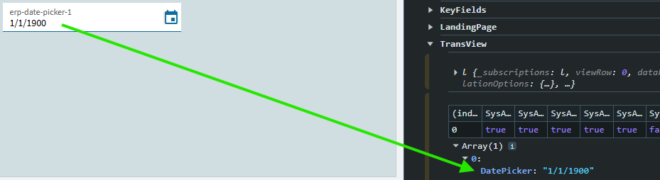

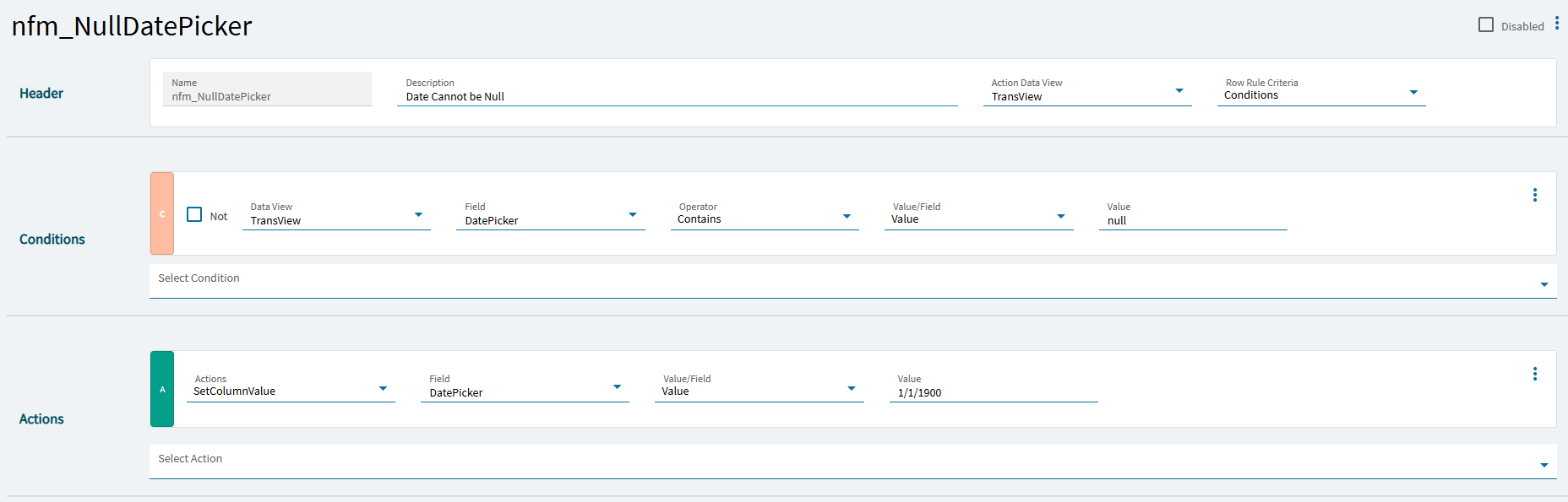

Can you control with data rules to set some default values:
For example, if I have a Date Picker (bound to TransView.DatePicker), initially it has no value.
I set the value in the UI… the value changes to “2026-01-29T00:00:00”
I delete the value in the UI… the value is null.
But… with a data rule, I can say if TransView.DatePicker contains a value of null… set value of TransView.DatePicker to 1/1/1900.
Seems to work.
Obviously 1/1/1900 is WIDE OPEN… which may or may not be ideal for your situation. But, it was just an example.
The crux of my thought was, if the user deletes a value and it then turns “null”, perhaps you can use a data rule to set a default value that won’t blow up your BAQ. Even if that default value is “”… its not null.

Well, the data rules wouldn’t show my custom filter dataview. Dashboards don’t come with TransView, so we have a custom FilterDV. It’s not accessible from the data rules.
Dang it.
Joe
You should be able to manually enter your dataview/fields and click the popup to set it if it doesnt show in the list.
