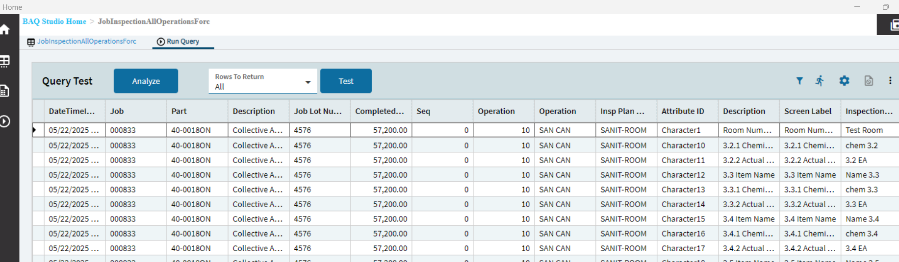

I go back to the BAQ designer and the BAQ works in both the classic and kinetic designer. Not a surprise as it works in Live and we have less data in Pilot.
