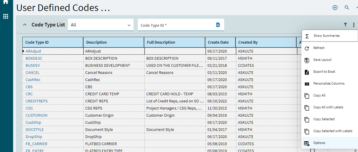

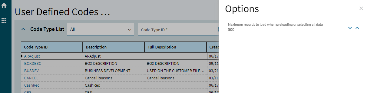

What happens if you change Max Records Options to something greater than 50k?

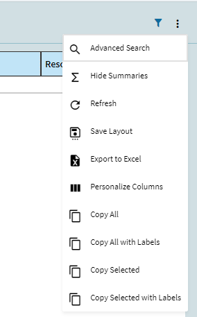

I don’t even have a button for Options. Are you in a later version or is there something I need to enable on my system in order to see that? I did create a ticket with Epicor and they said this is a known issue. Their workaround really doesn’t work. I refresh but still don’t get any data. I remove the column being grouped and then the data comes back.
