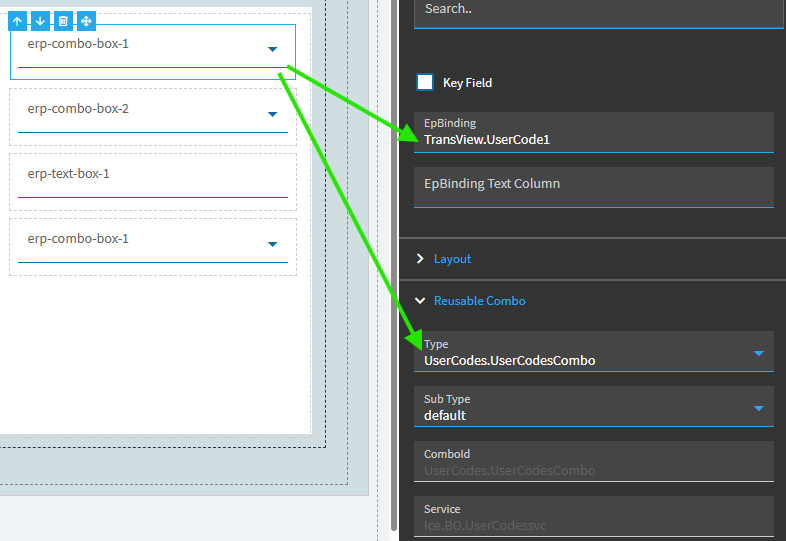

With Binding instead of Key Field:
“Key Field”, yes, will set the control to enabled by default… but this setting is primarily supposed to be used for key identifying columns in a dataview that identify the row/record. Part.PartNum for example.
A combobox NEEDs a binding. It is programmed to store a value (the value selected by the user). If you don’t have a binding, it doesn’t have anywhere to store their selection.

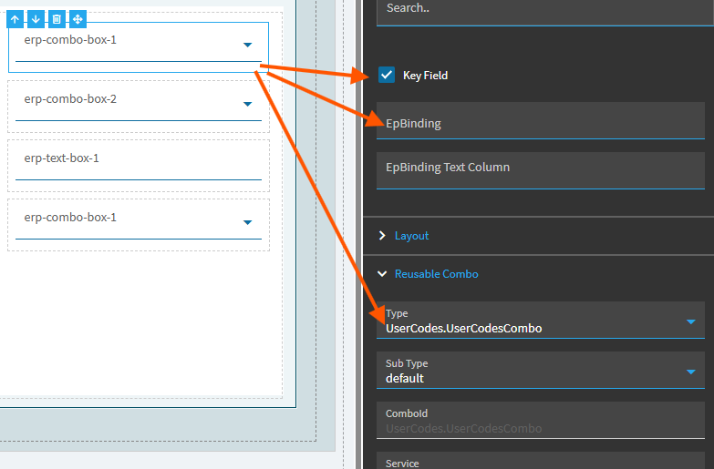

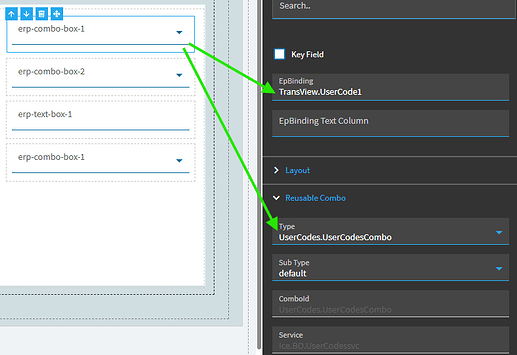

Yeah, I’ve done that too… but even outside of setting up the combo using a BAQ… even a stock re-useable combo will fail if it doesn’t have a binding:
Without Binding:
With Binding:
